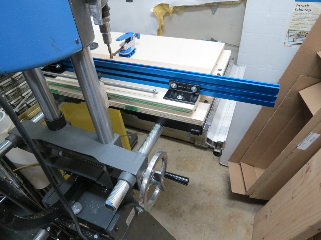

The parts I had ordered arrived this past week and today I got to work on the project again. When I had last left the project I was waiting on a muli-track and brackets that I was planning on using as a fence.
You can see how that worked out in the following picture, from the rear first.

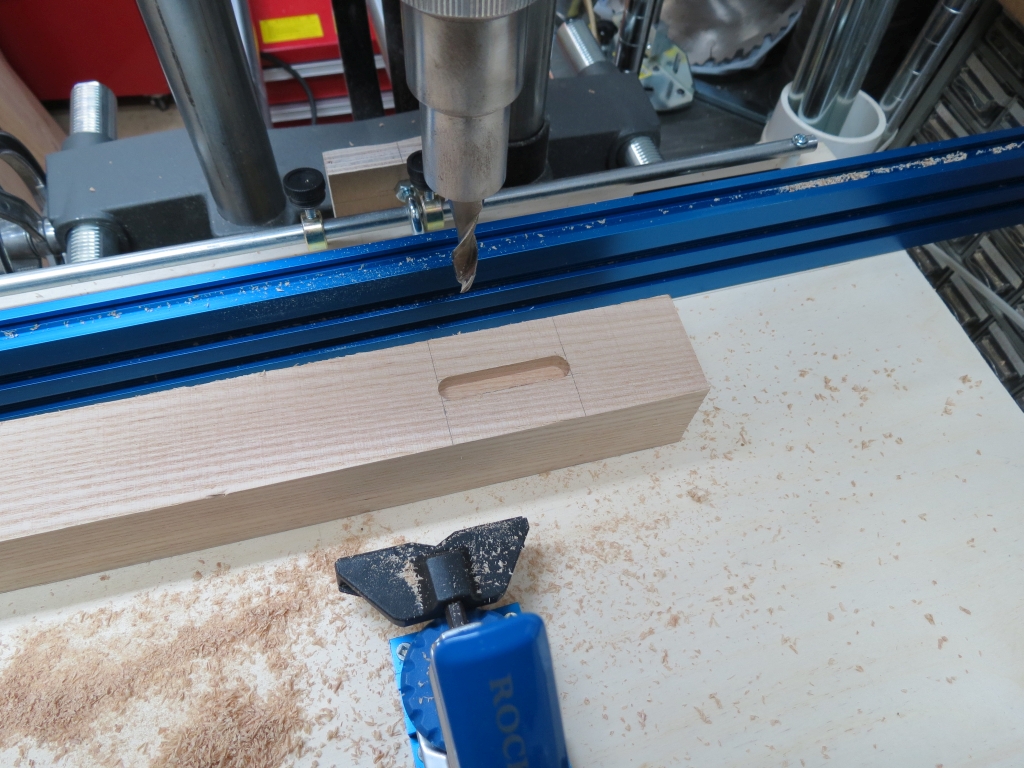

The next picture is a side/front view.

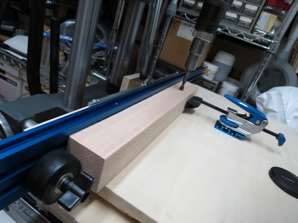

As you will have noted the "fence" is quite long, 36" to be exact. I'm not planning to cut it down unless I find a compelling reason to. As it is it will be simple to remove it from this jig and use it on another, why not take advantage of that?
It will surely be an add on to this project:
http://www.shopsmith.com/ss_forum/viewt ... 1&p=174897
The fence can slide left or right within the range of the mounting hardware which could also have advantages, maybe allow stock placement of larger pieces?

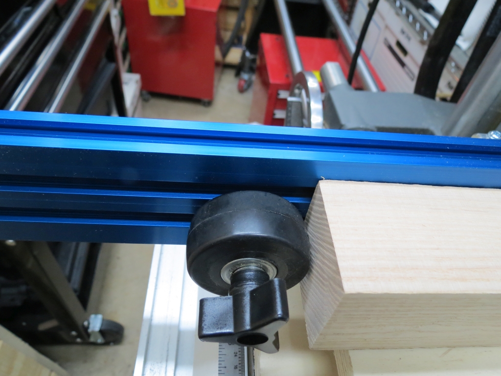

Right now I grabbed a rolling stop out of my collection to function as a work piece locating stop. Any hardware that works on t-tracks should work just fine. I had the stop on the left side but it could just as well been on the right, and as I mentioned the fence can be moved as well.

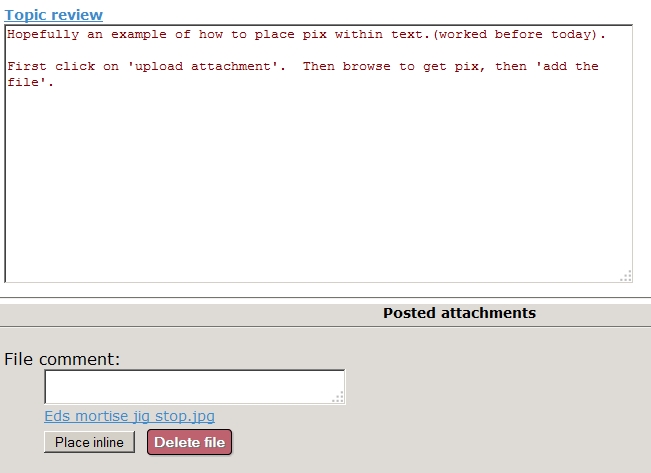

Hopefully an example of how to place pix within text.(worked before today).
First click on 'upload attachment'. Then browse to get pix, then 'add the file'. Click on 'place in line'.
Eds mortise jig stop.jpg (479.83 KiB) Viewed 2906 times
Which should have been here.
All that stuff(screen prompts etc.) keeps adding to the bottom of the screen(ya gotta scroll down to see/get to it). :(
So there you have two images embedded into text.
Clumsier than the 'old' way but tis possible to get there.
I had to do this over twice(human factors not very good with the flipping back and forth below the visible screen).

OK it is another day. JPG posted how it should work, this is also how I have been doing it. Last night when I added a second or third photo they all went to the bottom of the post and would not show up as in line. This is today's attempt to see if things are now working for me. It will also contain more information about the project.

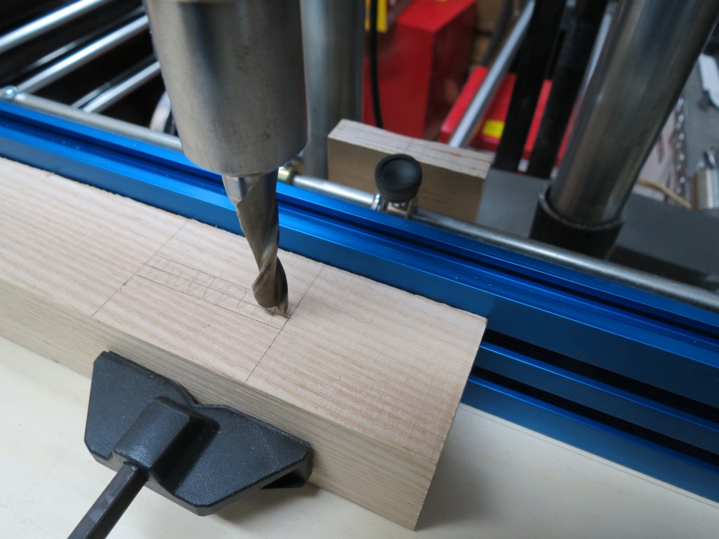

Before using the jig you will need to draw a mortise on the wood where you want it. This needs to be done to align to. I stared by doing so by wanting to make a 3/8" wide, 2" long mortise. The width is controlled by the router bit and I used the bit to set the width along the table travel path as shown here:

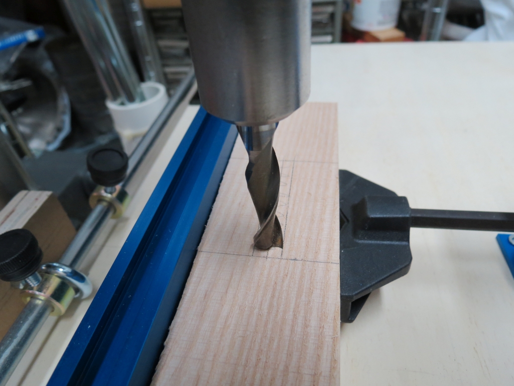

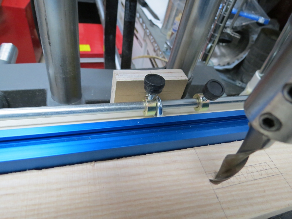

Once this is set I turn the bit to set the start point. The stop collar is locked at that point as shown here:
Now the table is moved to the location of the stop point. The stop collar for this point is set.
At this point the jig is ready to go. I proceeded to then make several passes to make the mortise, the results are shown.
While it works as shown I do have a few tweaks I need to make. The biggest one is that with the present spacing of the brackets the fence flexes/bows when the clamp is engaged. I have it set for near maximum force(500 lbs), maybe more then it needs?? I could reduce that but I think I would rather work at re-spacing the mounting brackets. This could have a ripple effect on other parts of the design. I do have other options to explore so the end is not yet in site.
One of the other changes I made that you might have noticed is knobs on the stop collars. I had been planning on doing that but when I went to the hardware store that stocks those sorts of part I found they had gone out of business.... Looks like it is now catalog only for me now as I know of no other stores in my area that had a good collection like they did.

Since each added pix creates an identical 'window' at the bottom(where the Place inline 'button' is) it is easy to place the wrong pix 'inline.
Also I neglected to state the cursor must be pre located where the pix is to go before clicking on 'Place inline'.

To avoid confusing myself :confused: , I upload and then "place inline" each photo before uploading the next one. :)
