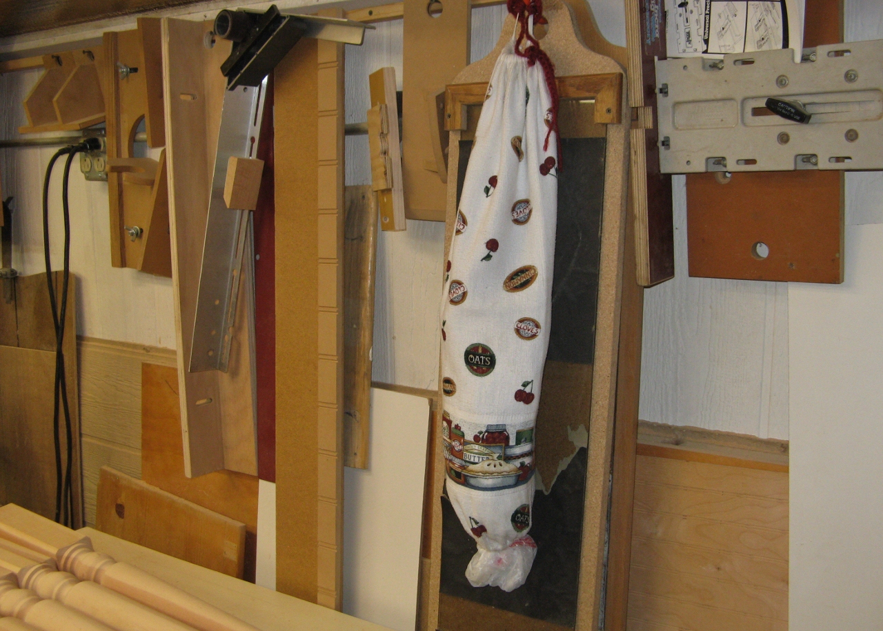

I Keep a supply of grocery sacks. They are useful for all sorts of things. Some time ago I found this sack holder tube you can stuff sacks in the top and pull them out one at a time from the bottom.

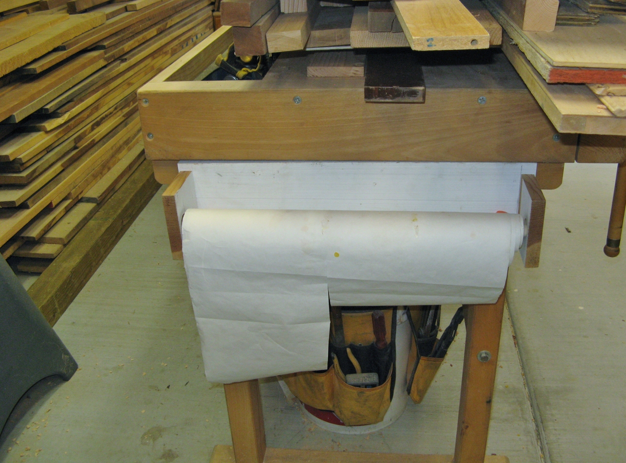

Because freezer or butcher paper has a plastic coating I have used it for many years to protect the bench top from glue,stain or paint. Also the uncoated side can be used to write on.

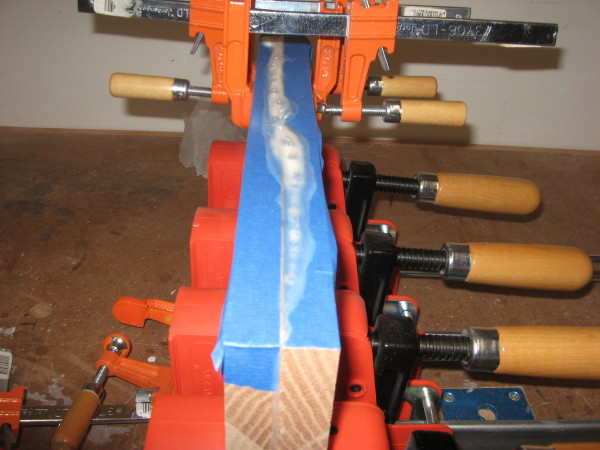

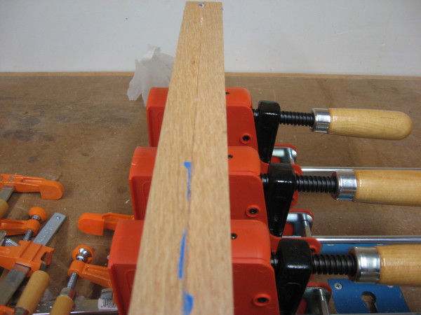

today tried using the blue tape to cover
squeeze out mess. works very good. also use
wax paper to protect clamps.
- IMG_3590.JPG (81.77 KiB) Viewed 1562 times
- IMG_3591.JPG (67.65 KiB) Viewed 1562 times

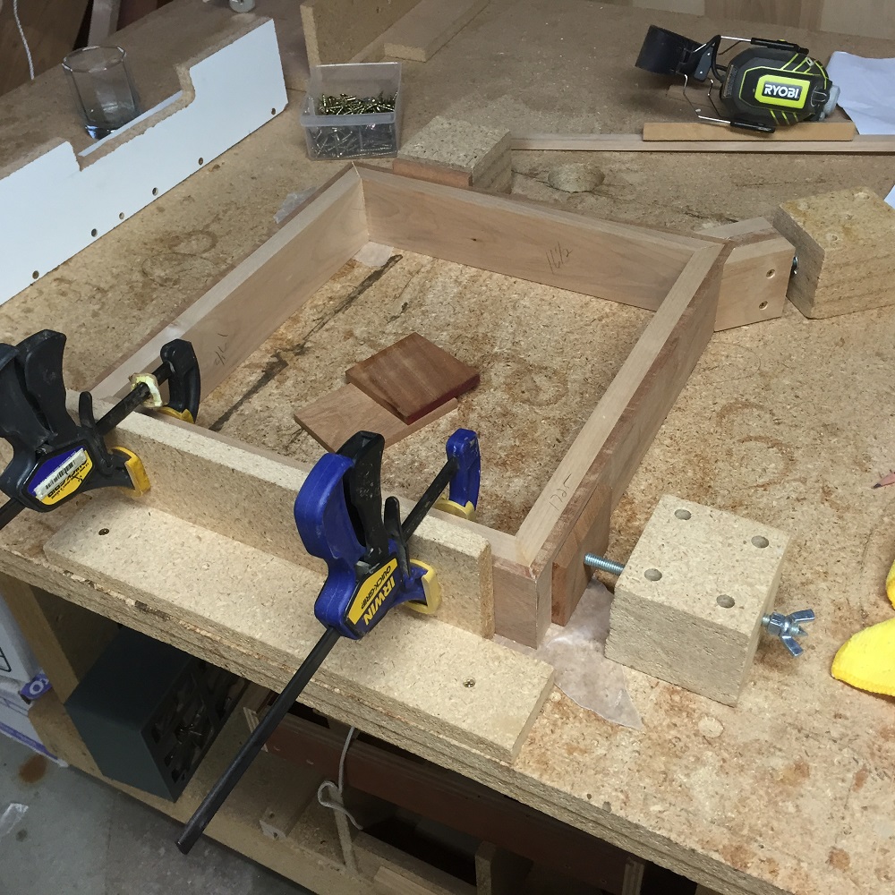

I'm a wax paper guy. I use a lot of it. Also my work bench tops are sacrificial. I use two sheets of particle board on a very flat frame. I clamp the two sheets together and then randomly drill about 10 3/8" holes and glue in some dowel pegs. That way there are no screws to hit with routers etc. I cut holes as needed to insert bar clamps, spill glue, router into it etc and then every so often drill out the dowels and toss out the top sheet and start all over again.
- table frame 2.jpg (388.06 KiB) Viewed 1433 times
