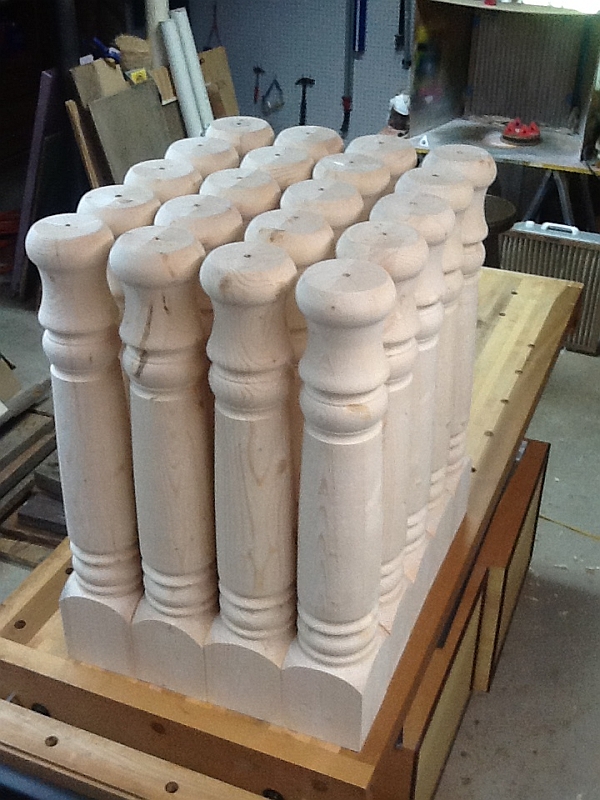

Just a thought here. How about routing a groove at the template so that the chips would fall through the hole. That way the chips woodn't build up.

Very well done. The jig is amazing as are the results! I use one that involves a router and have never been satisfied with results. I think I will give your concept a try. I have also toyed with the idea of buying the duplicator but it always seemed a large expense for the few times I have needed it. Thanks for all the info and photos.

That is one fancy toothpick!

An unexpected benefit to this project is that it turned profitable!!
There is a shop in my nearby town that makes and sells farm tables and other rustic furniture. To this point they have used square legs as they have no turning ability. I showed them the legs that I turned and received an immediate order for two sets. Once I delivered them, she ordered another set and one of her business associates ordered two more sets. As soon as she sells these tables she says she will order more.
This is working out well EXCEPT that she wanted legs that were 5" square. My problem is that my Shopsmith jointer only goes to 4". I had to come up with a different way to dress my lumber so I could make the blanks.
I managed to do this on my V-drum sander to flatten one side of a 2x6, jointed one edge and then used the Shopsmith Pro-Planer to take care of the other side. I was then able to glue up blanks and proceed with turning.
