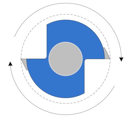

Here is a drawing of a standard (right-hand) router bit, viewed from the shank end. Trust me, this is what it looks like; I have a real bit sitting right next to me. In drill press mode, this is the top view. As you can see, in order to cut, it has to turn clockwise. Spin it counterclockwise, and it's a "burning tool" at best.

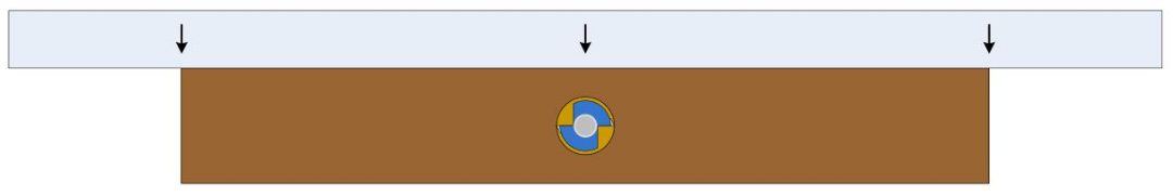

Next up, here is a drawing showing a workpiece centered on the fence, with the router bit in the initial plunge position.

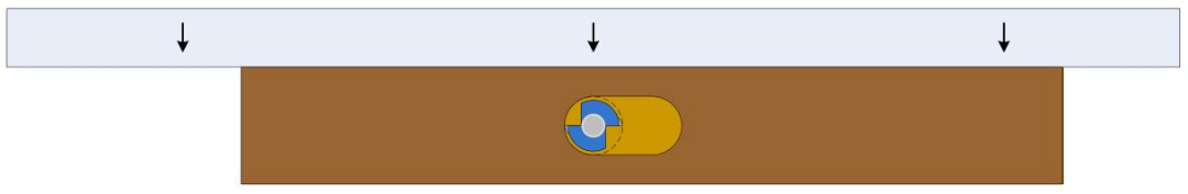

Now then, here's what happens when you move the workpiece to the right, as recommended by PTWFE.

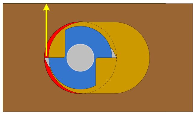

Which brings us to the good stuff. The next drawing is a closeup of the bit's cutting action as it slots.
Resultant force.JPG (25.35 KiB) Viewed 6056 times
The red crescent represents a chip that will be sheared off of the workpiece as it advances into a cutting edge of the bit.
The thickest part of the chip, requiring the heaviest cutting force, is right on the centerline of the slot. The shearing force that the cutting edge applies to the workpiece to make this part of the cut is represented by the yellow arrow. As you can see, it is pushing the workpiece directly against the fence.
As the cutter is entering and exiting the red crescent, the chip is very thin, and thus the cutting force is light. Plus, as jsburger noted, the entry and exit forces oppose one another, and thus cancel.
There is no opposing force for the yellow vector, because the bit is "cutting air" on the backside of the slot. So the resultant force is directly into that nice rigid fence. PTWFE got it right.
