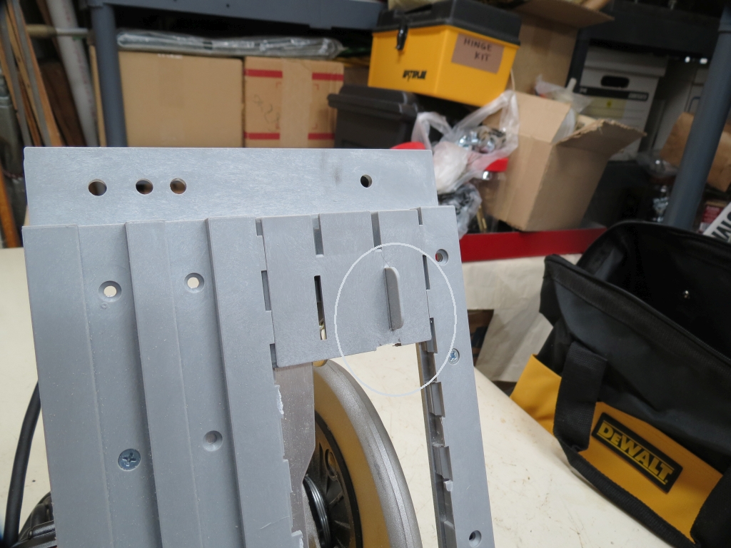

Today was mount the saw day.
Sole picture first. Not much to see but there it is. How much cutting out of the inserts and screw locations are saw and user dependent.

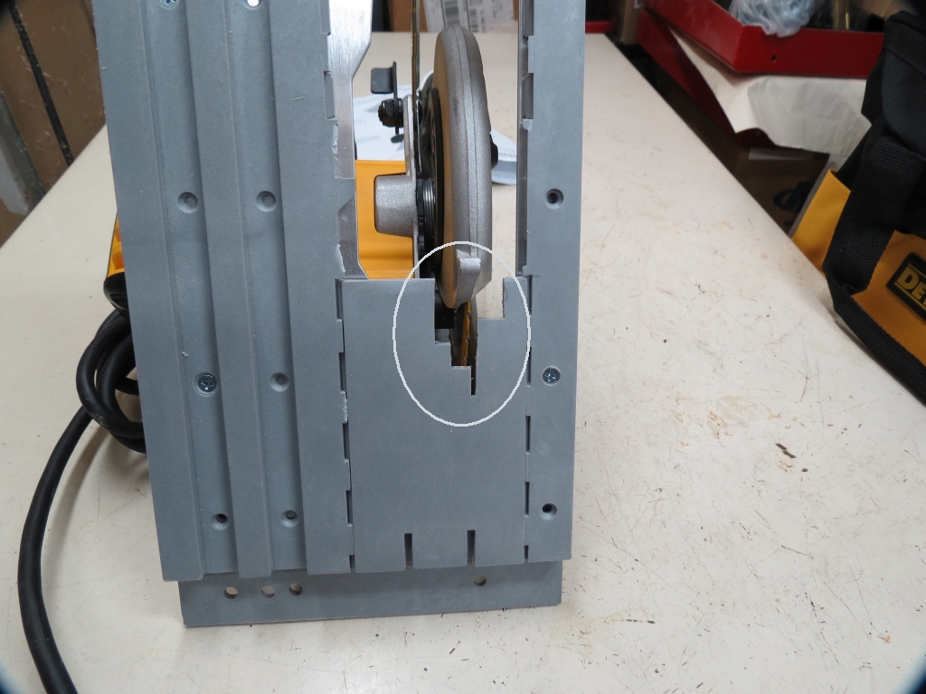

The zci area and the cut out for the blade guard are indicated by the oval. I used my bandsaw to make the clearance and the zci area is cut by the saw blade by plunging into it. The insert is replaceable if it is damaged or if you change saws or change blades. I'm deciding if it is worth having a couple of spares or not.
In my case the blade guard also required me to take a small amount of the insert where the "fin" goes. See the oval. As I expected the fin is to wide and will have to be adjusted to the blade kerf size. I have not done this yet.

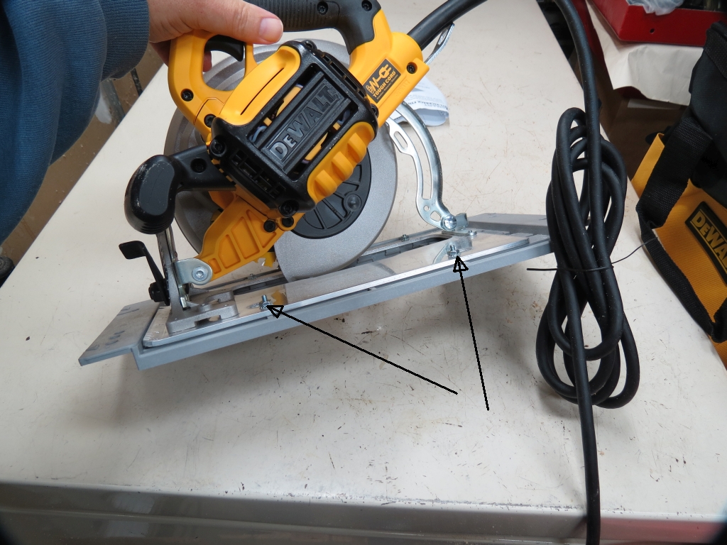

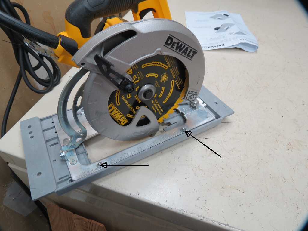

In the next two photos you can see where I picked to place the mounting screws. I did tap them on my first go around but thought more about it and decided to make them thru holes and put the lock nuts on. I feel safer with the lock nuts in place and I can see if they look like they are coming loose rather then getting a nasty surprise..... but again that is just me.
I did mount the saw plate to the complete the project but the camera battery wasn't up to taking any more photos tonight.

The fin was designed for use in situations where the material might close behind the saw cut, such as ripping stock that is standing up rather than laying flat or ripping dimensional material that might close as internal wood stresses are relieved by the cut. You may find you don't need nor want it while cutting typical sheet goods on a flat surface.

You might be right but I want to get it adjusted for times when I do want it installed.
I think another function is when you get to the end of the cut the fin is still in the kerf so you will have less chance of veering off, anyway I think I read that somewhere in there information or youtube video????
