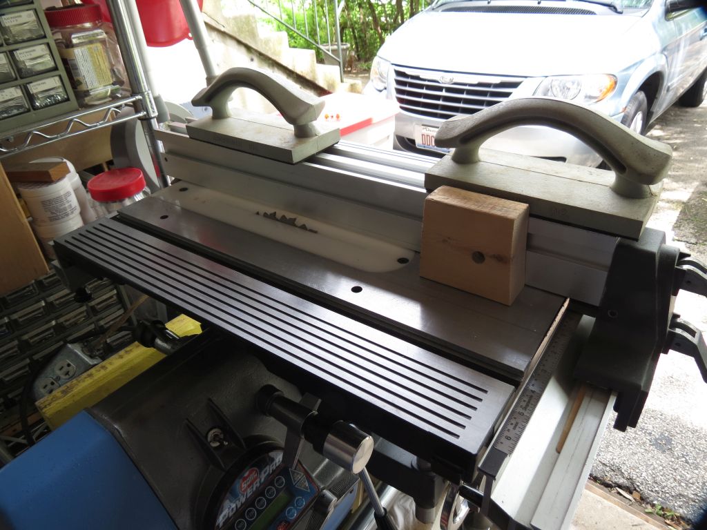

My vote is that the piece is rocking back and forth as you feed it over the blade. These types of cuts on small blocks are best done using a sled. It doesn't have to be anything exotic. Take a 6 or 8 inch wide scrap plywood and mount a board to it to allow you to clamp the piece to the sled. Then put the sled up against the fence and run it through the saw. Much more stable and infinitely safer.

In my mind there is only one cause of the mis manufactured grooves. It is workpiece movement as it passes through the saw. I see both movement away from a fence and failure to seat the workpiece flat on the table.
I don't support saw blade movement.

There were 8 of these pieces and the problem occurred on 3. (Not the last 3, mixed in.) There were twice the number of shallow grooves, no problem.
Once again the blade in 1/8" Shopsmith that I purchased new with the SS in 82.
I checked the arbor, it's on tight.
The push block as you suspected from a sacrificial saw horse.
I will continue making the serving trays and use the inferior parts. I have this thing about throwing things out, just because they are not perfect.
I can clean the blade and take a picture if anyone thinks that will help.
Thanks for everyone's comments.

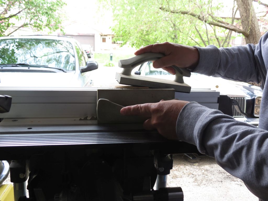

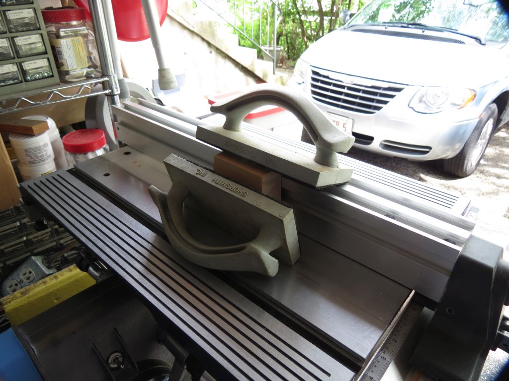

If you have to use the block size shown this is how I would do it.
There is no doubt in my mind what the issue is and how to solve it if we have been given all the facts. As in my first post on the subject I would start by putting in a ZCI and then use push blocks to push into the fence and down on the table. You should be cutting 1000's of these this way without any issues.
I would how ever suggest that the block size be made larger and then cut to size after.
