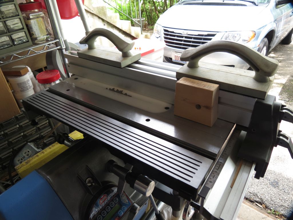

So in reply to some of the comments.
There were 8 of these pieces and the problem occurred on 3. (Not the last 3, mixed in.) There were twice the number of shallow grooves, no problem.
Once again the blade in 1/8" Shopsmith that I purchased new with the SS in 82.
I checked the arbor, it's on tight.
The push block as you suspected from a sacrificial saw horse.
I will continue making the serving trays and use the inferior parts. I have this thing about throwing things out, just because they are not perfect.
I can clean the blade and take a picture if anyone thinks that will help.
Thanks for everyone's comments.

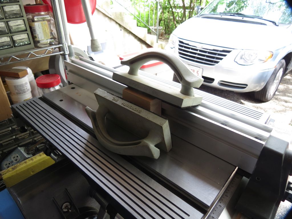

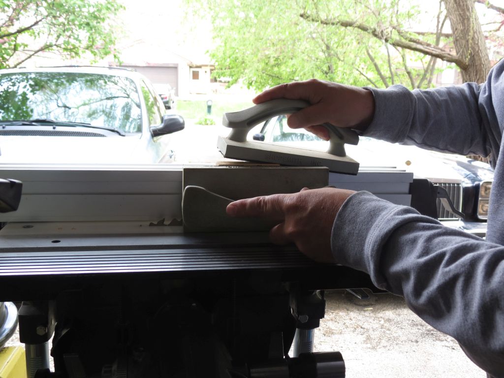

Re: Problem Ripping a Groove
Posted: Fri May 15, 2015 3:12 pm
by reible
If you have to use the block size shown this is how I would do it.
There is no doubt in my mind what the issue is and how to solve it if we have been given all the facts. As in my first post on the subject I would start by putting in a ZCI and then use push blocks to push into the fence and down on the table. You should be cutting 1000's of these this way without any issues.
I would how ever suggest that the block size be made larger and then cut to size after.
