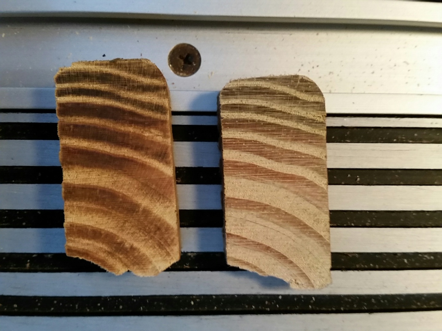

I put the one blade on, the 1/2 inch. Tried a cut. Yeah, the old one was seriously dull. The new one, like hot knife through butter. And no burning.
The left was done with the old blade, the right with the new. Now, what to do with the old blade, can that go in the recycling. It's a bit sharp, but... not really.
