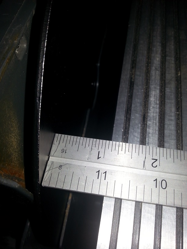

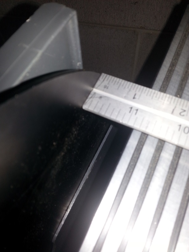

Well Guys You are helping the biggest dope there is
i don't know why i didn't so this in the first place maybe it was because i wasn't felling the best or my mind is on my vacation to the beach
any way. As you can see from the pictures I was able to do a rough alignment of the table
i need to do a more precise alignment but at least the table is straight
I might at some time drill out the rear trunnions but for now I'll work with this.
- Infeed side of the table or Front of the table
- Infeed.jpg (130.7 KiB) Viewed 1297 times
- Outfeed Side of the table or the back of the table
- outfeed.jpg (92.77 KiB) Viewed 1297 times
