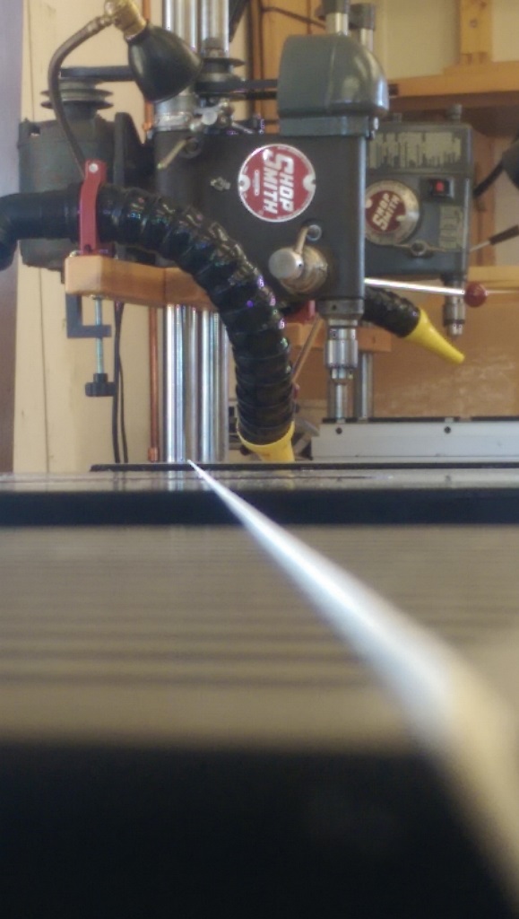

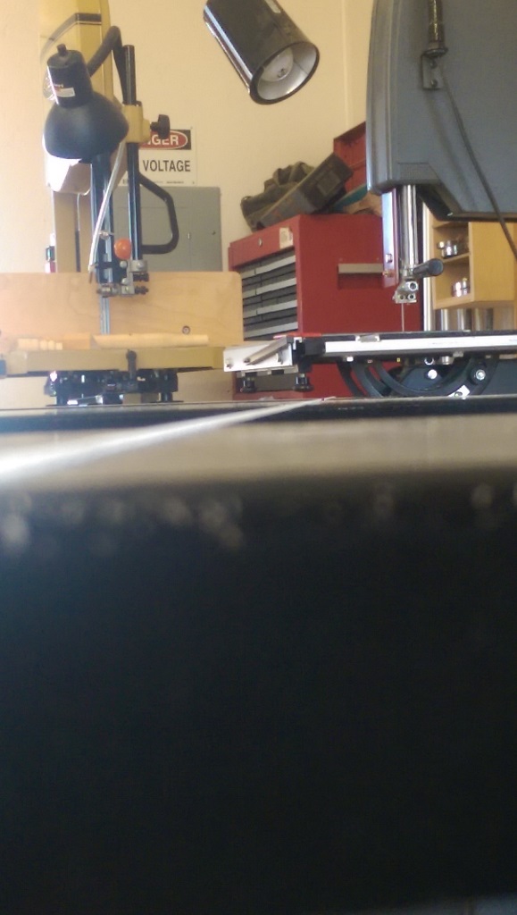

OK, I don't remember nor can I find the thread I wanted to post this to but it is relevant here so here goes.joe_cool wrote:I wonder if John Burger after doing his double tilt upgrade if his extention table aligns on both ends?
This was all done on my MK 7. First I checked the table tilt to the blade. It was dead on 90 degrees. Then I checked the miter slot parallel to the blade. I am off 0.005". Close enough and not worth fooling with. Then I checked the main table for flatness. It is not perfect but not bad. Left to right across the front the right corner is down about 0.008". Across the middle the right edge was down about 0.006". Across the back end it was flat. Diagonally left front to back right it was flat. Diagonally right front to left rear the front corner was down about 0.008" as expected.
Next I installed my two fixed extension tables leveled them with the main table and checked for co-planer with the main table. They were both off slightly left to right. So I thought I would use Dusty's method using the connector tubes. I have four short tubes and none of them are perfectly straight. I rolled them across the Powermatic cast iron table top and they are all out 10+ thou. Anyhow, I loosened the bolts on the right extension table, slid the main table to the right, installed the connector tubes and tightened the locks. The back of the table came up fine but the front was low about 0.030". Huh
Once everything was level and co-planer I checked diagonally across the entire surface using Dusty's method with a string. I don't have a straight edge long enough either Dust. You said something to the effect that the results are far from perfect. Well, my results are as close to perfect as I think you can get. It is pretty hard to tell from the pictures but those strings are dead straight when you sight along them and if there any gaps to the table I couldn't see any.

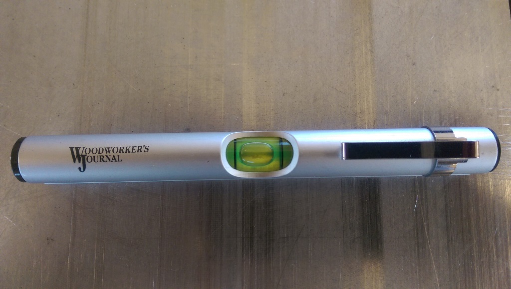

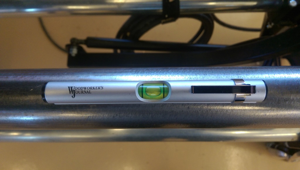

Using the handy dandy level that is shown here, are all of the tubes (Way and Bench) and the Main Table at zero tilt all level (or at least out of level by the same amount in the same direction).
