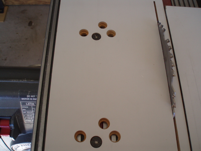

When I first initiated this thread, I was trying to figure out why the Auxillary Cross Cut Table had four (4) sets of holes for mounting its small plastic miter bar.
[ATTACH]1465[/ATTACH]
Now I am wondering whether or not four sets of holes is typical. All of the catalogs that I have, that show images of this table, show only two holes (1 set).
What gives?
What gives?

Bruce, Yes they still make it. Part #555526. It is a gray color now, not white.
Ed, I noticed that Nick used it during the Saw Dust Session today but his only has one set of holes. With only one set of holes, I wonder what the difference is if you swap it end for end? Are the holes centered?

dusty wrote:Bruce, Yes they still make it. Part #555526. It is a gray color now, not white.
I flopped mine all around and it didn't seem to change a thing. I didn't measure but it was no where near touching the blade.
Frankly I'm tempted to either buy or make a sled like the one that was on e-bay awhile ago. It was a full sled with a replaceable piece where the blade cut. So you could replace it every time the kerf wore wide.
