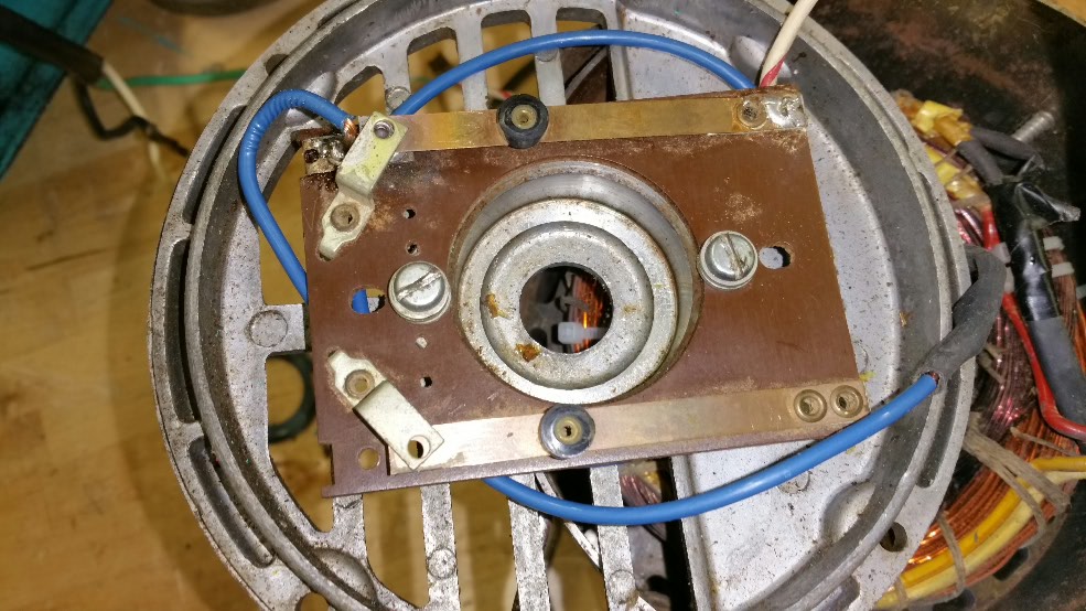

Re: Mark VII speed control
No worries!!
I do appreciate all of the help thus far. The motor works one second and it doesn't the next. I'm missing parts for the starter switch / rub plate which makes me feel less crazy.
Starter switch missing paralell contacts.
I soldered it like so because it was the way it came out of the motor.
It doesn't even have the solder pad for the second contact.
I only had that spacer thing in the front end cap.

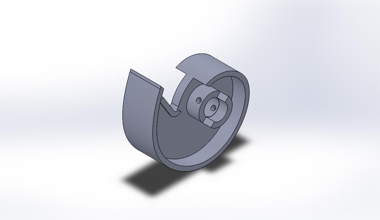

The control cam is ready. JPG, I have fixed the dimensional issues on the holes that was discussed.
The pin hole measures precise, the main bore is slightly undersized, this will have to be sanded or filed out by the user to get a good fit on their particular shaft... now that just sounds dirty
There is a utube video below if you want to see it in motion / action.
https://youtu.be/b07svtnY__Y
Now... on to the rack.
- controlcam version 2.JPG (106.42 KiB) Viewed 2345 times

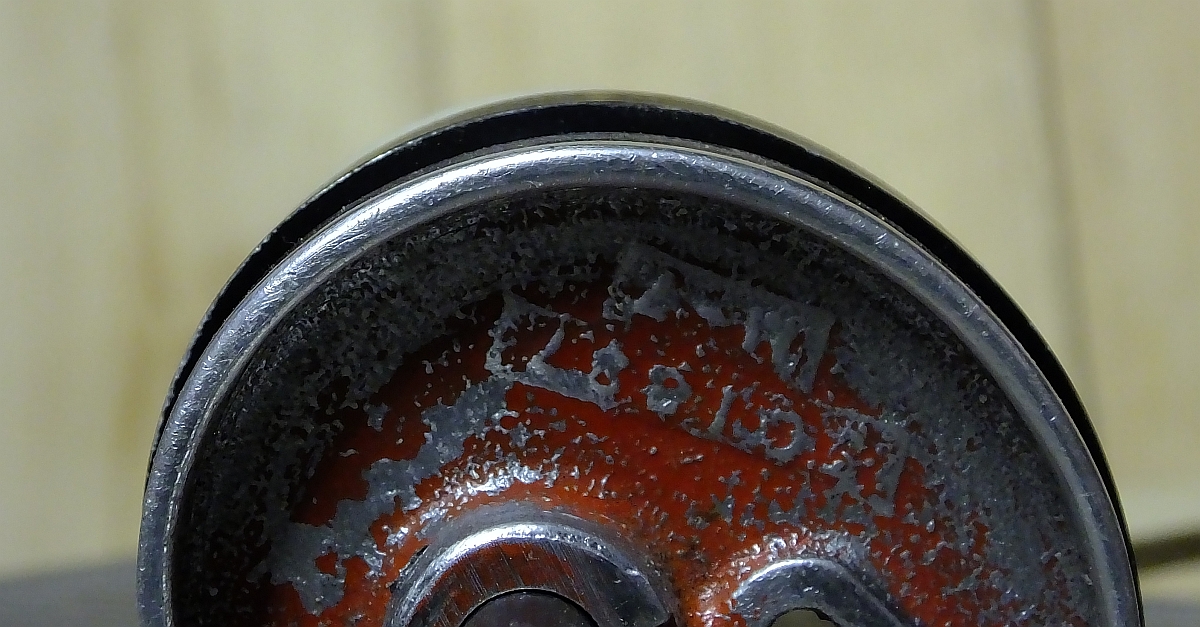

A tale of three cams.
[A] My MVII came with a third party aluminum cam.
I had already obtained a CNC produced copy.
[C] I recently received one as described above.
A was different from B
C is very close to B
A is red B is black C is White
The black cam is silver(aluminum) in the second pix since I filed down that edge.
FYI
FYI

I hadn't seen just how flattened out that part of the cam had become. I wonder if that is due to distortion in the nylon cam i based it on.
I'll have to adjust the model.
Can you, by chance, take a photo of the silver cam's profile head on with a scale in the background? so I can compare the profile I used to create the model and the CNC cam.
I've done a bit of cam design for converting old cam machine tools to CNC, and I'd bet that cam is supposed to be "linear" -- i.e. a straight line in polar coordinates. Radius = k * Angle. That should be easy to check if you already have a model.
It's also possible to tweak the cam profile to compensate for the slightly nonlinear cam-follower kinematics, but I doubt they would have bothered.
