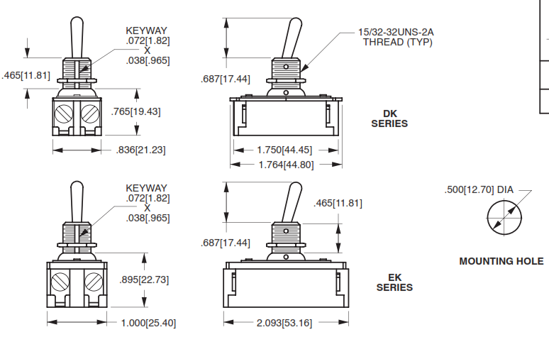

FWIW, I believe the switch 'barrel' is 15/32, not 1/2.
Re: 10ER Switch
Have you ever seen a switch advertised to have a 15/32" barrel?
Posts: 3814
Re: 10ER Switch
dusty wrote:Have you ever seen a switch advertised to have a 15/32" barrel?
I can't say for sure if I've seen them "advertised" that way, but both dimensions are correct. Here is the part drawing from the datasheet for the switch that I suggested a couple of posts back. Note the 15/32-32 thread callout. It's an industry standard.
I used the parametric search engine at Digikey.com to find a suitable switch. With it, you can filter either by panel cutout size OR by bushing thread size.

But the recommended cutout is .500" which was really my point though poorly stated it was.
wa2crk
Posts: 3080
Location: Leesburg, Fl
Re: 10ER Switch
Post by wa2crk »
15/32 is for clearance in the 16/32 (1/2") hole.
