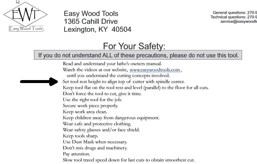

Hi again,
If I can work it in to my scheduled I will take some pictures of my tool rest, and hand made tool tomorrow. The tool rest is the foundation of your turning and it needs to be smooth and flat. It took a fair amount of effort to get the shopsmith one usable. Filling followed by sanding. It is an on going effort but worth it.
In order to keep the tool rest in top condition you need to break the sharp edges of your lathe tools. The steel is harder then the cast iron and will tear up your tool rest.... you can ask me why I know this, well, from experience, yes I did it to myself. Got a new tool and was so excited to use it that I didn't pay attention to the sharp corners..... BTW nicer tools come with the edges already rounded over.
So far I'm sold on easy tool stuff and have a few of their tool and would like to add more to my collection. I can only afford a couple every year, I look for the spring sales and add to my collection then.
Here is a clip from the instructions that come with the ruffing tool. I highlighted, well OK I arrow-ed the part about tool position but please read the whole list.
- ScreenHunter_52 Oct. 26 22.58m.jpg (69.4 KiB) Viewed 7767 times
Re: Help with lathe work
Posted: Tue Oct 27, 2015 10:32 am
by charlese
reible wrote:Hi again,...
Excellent recommendation!!!! ---

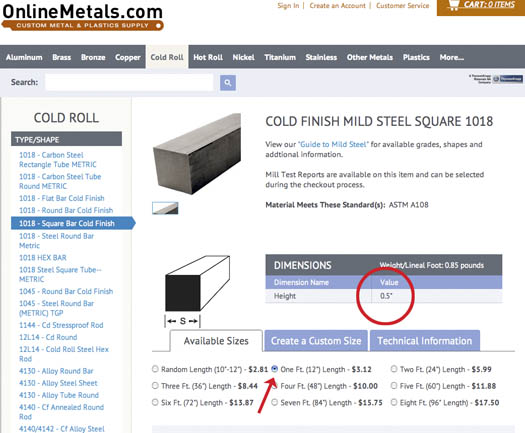

Sources for making carbide chisels (The grinder does not come with cutoff disks). Online Metals shipped pretty fast, too.
- grinder.jpg (73.57 KiB) Viewed 7690 times
- steel_bar.jpg (73.77 KiB) Viewed 7690 times
