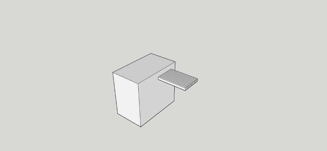

I asked the question because I was told that end grain use more stock and I didn't see it, but after reading the responses it's pretty clear.
As to why make/use a wooden one. In my case this is a commission. My customer owns an 1920's bungalow and the kitchen, like many kitchens from the period have built in cutting boards. The one I'm to replace has long ago passed it's useful life. They slide in under the counter top and are cantilevered out in use and slid into the cabinetry when not.
Thanks for everyone's input.

With that tid-bit of additional information, I might suggest that the end grain approach would be wrong. This approach would subject the glue joints to impact forces (downward pressures) that they might not withstand. I would want the pull-out board to have glue joints that run perpendicular to the cabinet in which it is stored.berry wrote:I asked the question because I was told that end grain use more stock and I didn't see it, but after reading the responses it's pretty clear.

The house before this one was an oldie but goodie. It had a county kitchen and pantry off to the side. It also had the slide in/out cutting board. It was thin and with the cantilever you would have a major effort to use end-grain for that application. Ours also slid out so it was not necessary to use it sticking out but still awfully thin for end grain. It has been some years but as I recall the thickness was like 3/4".
