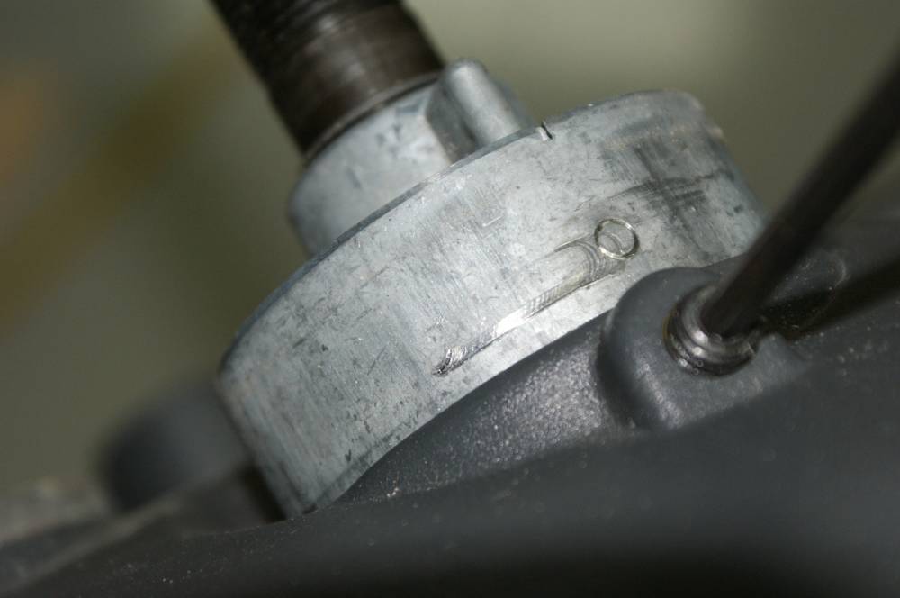

I had other problems with the newer pinion shaft in that if the setscrew was tightened on the housing that is next to the depth stop, the quill was difficult to move either up or down. The quill would bind up after about 20 holes when doing a production run. I was never able to determine if the spring housing was flexing when the setscrew was tightened or not but the tightness of the setscrew did make a big difference. One of these days I will pull both assemblies and try to figure it all out. If I can find it I will post a pic of the gouge in the spring housing that was caused when I had the problem. Right now the PP quill is in the PP headstock but the pinion shaft is from my original 1983 headstock.

OK I'm back
I found the pic of the original pinion shaft from the PP. The original position of the setscrew is at the left in the pic and the gouge is where the spring housing rotated in the shell.
The brighter set screw mark is where I tried to tighten it in place and I got a lot of binding after. The older pinion shaft worked a lot better. There was a lot of metal filings in the spring housing and I cleaned it out using WD40 and compressed air. I left the situation where it now stands due to a conflict with D*** who had a very condescending attitude. After switching parts my PP works OK so now I will have to pull out my old headstock and put it through it's paces. It needs a lube job anyhow.
Bill V
