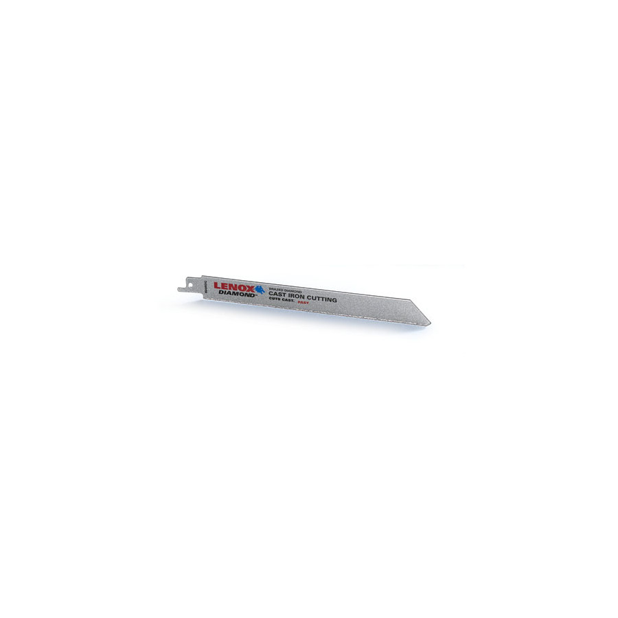

A diamond-grit reciprocating saw blade should do the trick, if you don't need the ends perfectly square. I've used them to cut heavy machine castings. My local Lowes stocks them.
