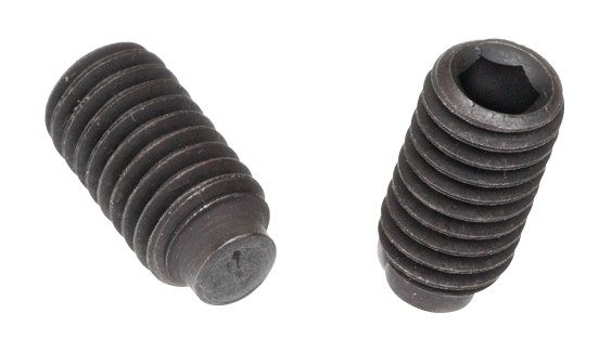

Re: Adjustable Stop Collar Set Screw
JPG wrote:I would make sure it is NOT a cup or point setscrew.
I would make sure that it is a 5/16"-18x1/2" Half Dog (514748) since that is what Shopsmith installs in a new unit.
http://www.shopsmith.com/ownersite/prod ... Collar.pdf
half dog.jpg (24.98 KiB) Viewed 3949 times

The Adjustable Stop Collar (555937) has a 5/16-18x3/8 Brass Tipped Set Screw in them. It is available for service also.
Re: Adjustable stop collar
Maybe this is one of those situations where there are multiple wrong answers. Maybe Shopsmith has changed in mid course. This document, which came with each of my three Adjustable Stop Collars, identifies the set screw to be a 1/2" half dog. I can look at what is installed in mine and tell that it is not brass.

You mentioned the set screw was a 'dog nose'. That mean it is a half dog? I would have expected it to be an oval or flat. ???
Sorry, yes it is a half dog so flat.
BTW, there are no brass set screws on the 10ER as you suggested in another post. There are knobs with brass threads however.
Posts: 6585
dusty wrote:Maybe this is one of those situations where there are multiple wrong answers. Maybe Shopsmith has changed in mid course. This document, which came with each of my three Adjustable Stop Collars, identifies the set screw to be a 1/2" half dog. I can look at what is installed in mine and tell that it is not brass.
I agree Dusty. I have four and they are not brass tipped.
