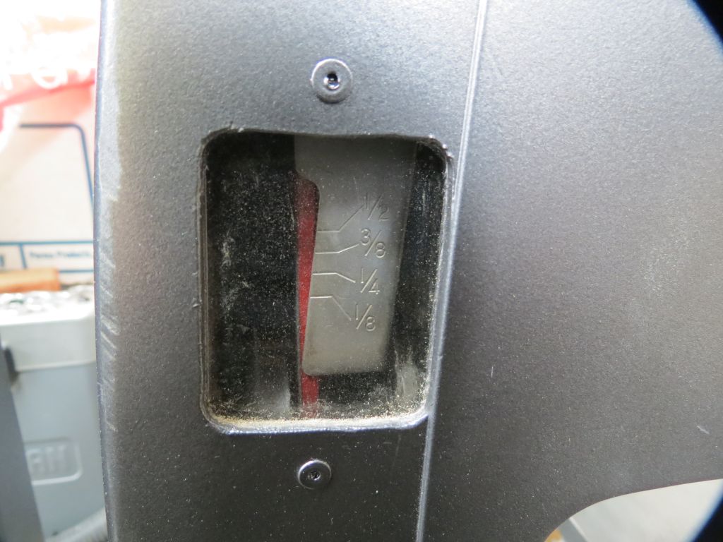

In this post I took a lot of the suggestions that had been made for improving the old cast iron bandsaw and grouped them together and did them. This included adding a window, a hole for the wrench and a dust port. You can find this and a lot of other pieces of information here:
http://www.shopsmith.com/ss_forum/maint ... t8361.html
I have not had the cover off my bandsaw in quite a while so the window has not been cleaned in a long while. I have a cleaning as a thing to do soon but for now you can see just what my dirty window looks like. I have no problem reading and setting the tension.
The dust port helps but you still end up with sawdust in all the nooks and crannies inside the saw and saw dust comes out the bottom. I built a test port for the bottom but it is too much work to put on and take off so it off all the time until I come up with a better mounting method.
Posts: 6584
Re: Band saw dust port
reible wrote:In this post I took a lot of the suggestions that had been made for improving the old cast iron bandsaw and grouped them together and did them. This included adding a window, a hole for the wrench and a dust port. You can find this and a lot of other pieces of information here:
Ed,
That is about as dusty as my window ever gets. I think band saws inherently spew dust. The SS is not too bad but my 14" Powermatic spews dust everywhere and it has a 4" dust port. I will say though that I only have a 2 1/2" hose connected to it from a 4" line.
