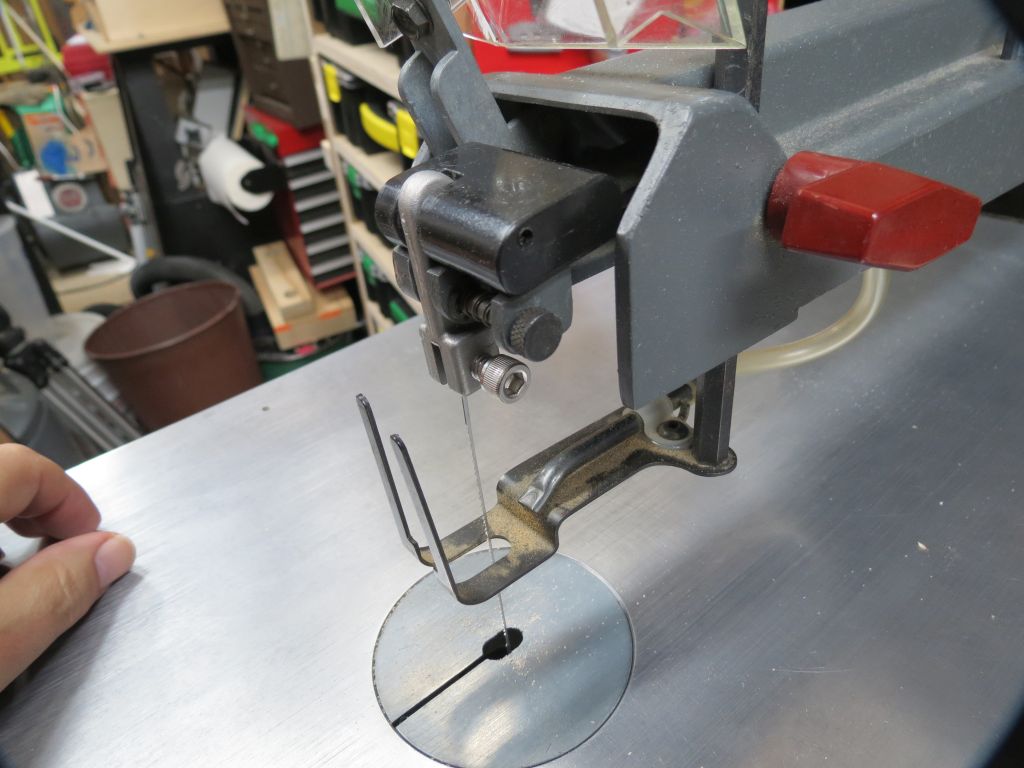

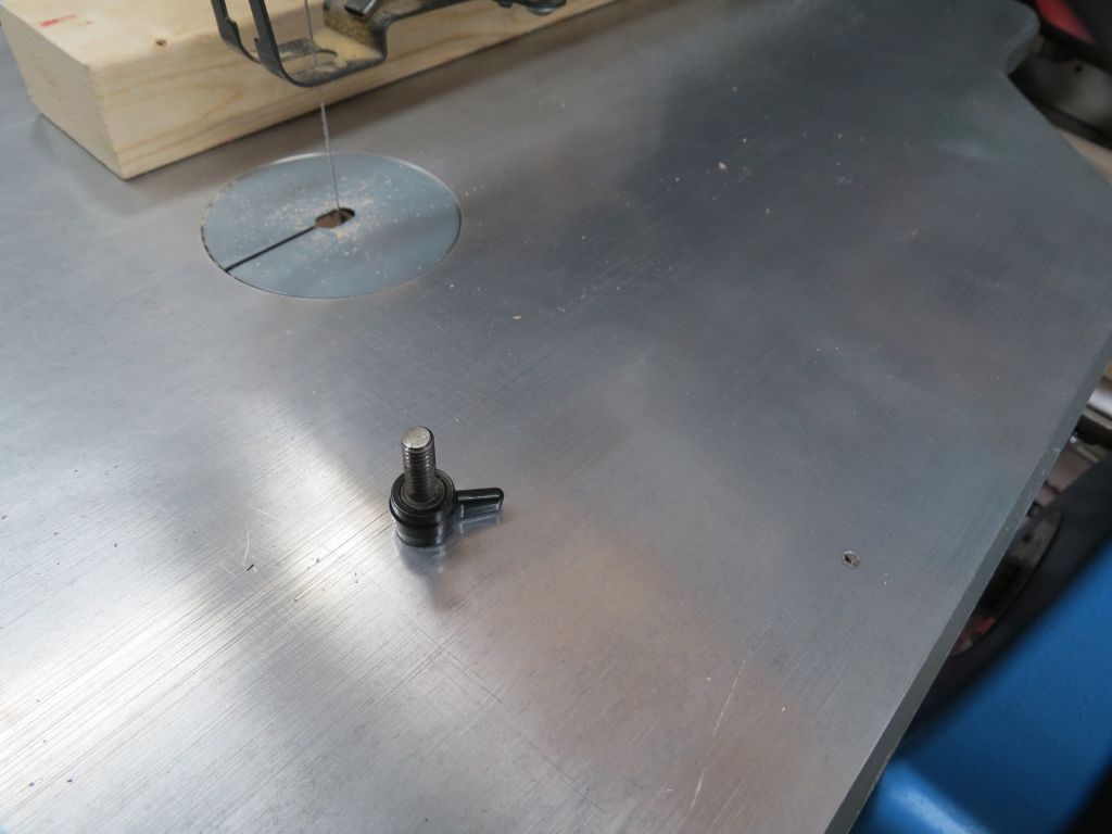

The parts that shipped with the upgrade have a flat that is already there as seen here:
I have replaced them with these:
So far they are holding a lot better, I think due to my use of a t-handle wrench to tighten them rather then my fingers on the small levers.
Time will tell if I like this or the other arms better, but for now I'm thinking he cap screws are better for me.
algale wrote:I have the teal version but if you upgraded the blade changing system I believe it is the same as mine. Blade popping out of the upper holder is a problem for me too. I read a tip about using a piece of sandpaper to roughen up the ends of the blade. I also read a suggestion to grind the ends of the screws flat but have not tried it.

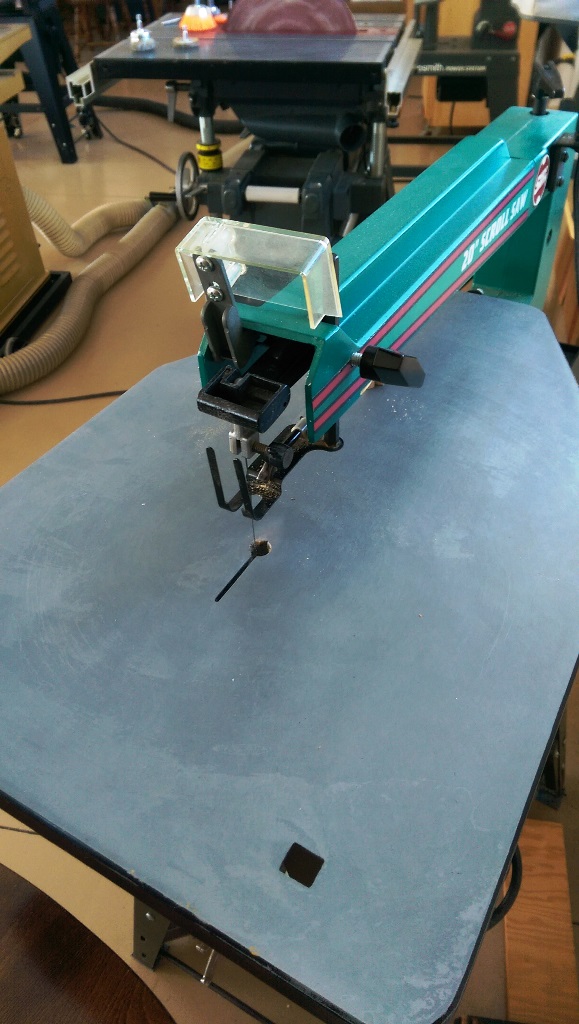

I would like to see some pictures from people who have the new saw (teal) when they put the blades though small drilled holes on inside cuts. It seems the hold down gets in the way but having the slot allows the blade to tilt forward enough to be workable but on the teal saw the slot is no longer there...... just a hole.

No photos today but the teal table has a long slot built in to the table for tilting the blade. Ok. Here is a photo. Image

:confused: My stand alone Teal saw has a slot. The pictures in the SS catalog of the MK V mount saw have the slot.
Also I notice the stand alone scroll saw in no longer in the catalog. Has it been discontinued?
Re: Scroll saw "tune up" the app
OK then it does have the slot! I couldn't see that or didn't see that when I was looking at the images before. That means that it works pretty much like the saw I have except the area is just cut in the table rather then an insert.
It also makes sense, so the foot goes up pretty high and then you can tip the blade forward and insert and slide back to vertical, right?
What is the square hole in the table front for?
algale
Posts: 4841
Post by algale »
reible wrote:OK then it does have the slot! I couldn't see that or didn't see that when I was looking at the images before. That means that it works pretty much like the saw I have except the area is just cut in the table rather then an insert.
Holds the lower blade holder on its side, thumb-screw up, for inserting blade. Personally I find it easier to just hold the blade holder in my hand.
Posts: 6585
The lower blade block has a spring loaded pin that holds it in the arm. The idea is to pull the pin and remove the blade block. It then fits side ways in that hole and you loosen or tighten the blade thumb screw to either remove or install the blade. In reality it is just as easy to leave the blade block in place and just put the blade in under the table.

Thank you so much Reible!! This is already a step in the right direction. I really like the thumb screw conversion as well. There is also a larger slotted black plastic piece with holes about the size the tension spacer and I'm clueless as to where that might go also. I'll try to send a picture of it. Thanks again for reply.
