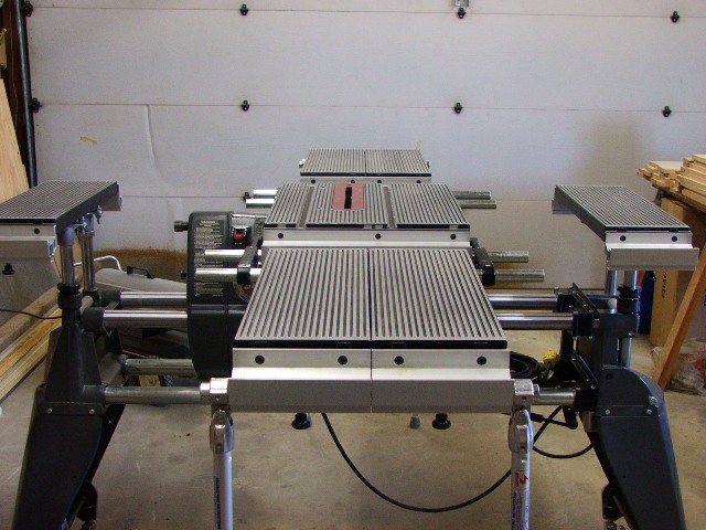

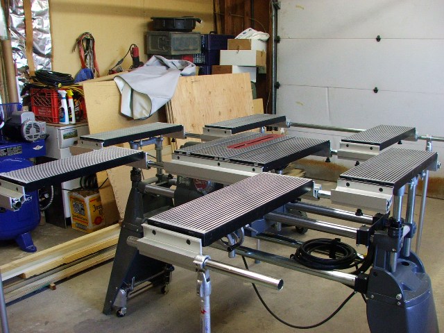

The SS table saw is more than adequate if you set it up for large stock.
- DSCF0456 (640x480).jpg (106.52 KiB) Viewed 7626 times
- DSCF0453 (640x480).jpg (92.23 KiB) Viewed 7626 times
Re: Amazing turning project, done on a Shopsmith
jsburger wrote:The SS table saw is more than adequate if you set it up for large stock.
Impressive for sure, but, not everyone has double sets of aux/floating tables and legs.
Well, I didn't either until I bought them.JPG wrote:jsburger wrote:The SS table saw is more than adequate if you set it up for large stock.
The result I assume of using the main table etc. for the sanding station or the drill press. Hmmmm you musta also bought a table/carriage.jsburger wrote:Well, I didn't either until I bought them.JPG wrote:jsburger wrote:The SS table saw is more than adequate if you set it up for large stock.

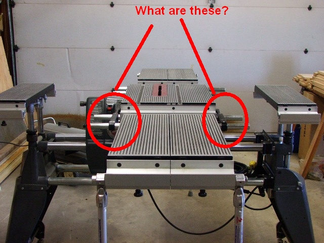

How did he do this?
- full table table saw table 2.jpg (92.23 KiB) Viewed 7465 times
Actually, no. All of the extra tables and most of the other needed parts in the pictures above were bought on eBay about 10 years ago. Notice those pictures were taken in my garage and not the current shop. The current shop was built in 2009.JPG wrote:The result I assume of using the main table etc. for the sanding station or the drill press. Hmmmm you musta also bought a table/carriage.jsburger wrote:jsburger wrote:The SS table saw is more than adequate if you set it up for large stock.
The shorty sanding station was made completely from parts from eBay that I collected over a year or so around 2010/11. I just waited for like new parts at a reasonable price.
The dedicated drill press was assembled the same way except for the head stock and the bench end castings. Those came from the upgrade of my MK V to a MK 7 in 2013.

They are SS extension table brackets.rjent wrote:How did he do this?![]()
http://www.shopsmith.com/ownersite/cata ... racket.htm
Those be main to floating table connectors.rjent wrote:How did he do this?![]()
I cannot find them, in the on line stuff.
Have they been discontinued?
No, they are still there. See my previous post. Took me about 10 Min. to find them since I didn't remember what SS called them.JPG wrote:Those be main to floating table connectors.rjent wrote:How did he do this?![]()
- rjent
- Posts: 2121
Well, ain't those special.jsburger wrote:They are SS extension table brackets.rjent wrote:How did he do this?![]()
Thanks John, may need some of those. I use the other machines (10ER and 500) as infeed and outfeed but that is kind of cool ....
