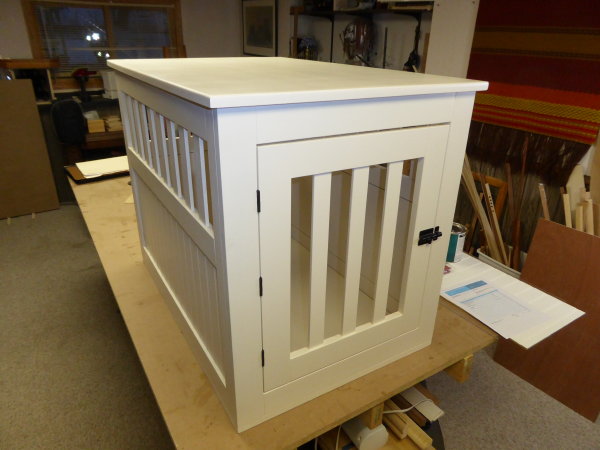

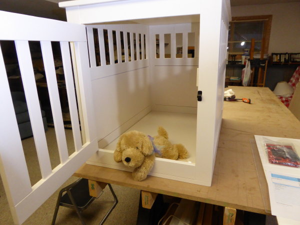

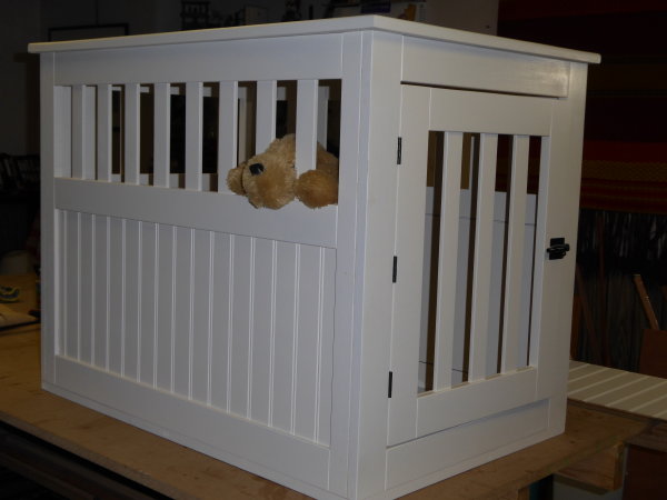

Thanks to everyone who offered advice. In the end I used biscuits. Here's a couple of photos of the completed kennel. It was my first attempt at spray painting using a HVLP sprayer. I tried to take some pictures that would show the surface but failed miserably.
Kennel 477.jpg (57.73 KiB) Viewed 4551 times
Kennel 481.jpg (61 KiB) Viewed 4551 times
Kennel 485.jpg (44.76 KiB) Viewed 4551 times

Looks good.

berry wrote:Thanks to everyone who offered advice. In the end I used biscuits. Here's a couple of photos of the completed kennel. It was my first attempt at spray painting using a HVLP sprayer. I tried to take some pictures that would show the surface but failed miserably.
It looks great in the photos. So in words, then, what did you think of the HVLP sprayer? I've got a really-big finishing project coming up, and I'm leaning in that direction.
