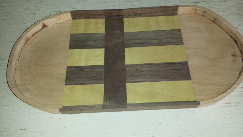

I totaly believe reible has the best answer, but I wanted to work on this scrap with the idea of being a snow day and need to work with what one has on hand.
I didn't use the core/round bit, as I didn't like the results in scrap wood.
Resorted to forstner bit and stright bit free hand.
- smallsishdishedout.jpg (105.71 KiB) Viewed 2951 times
