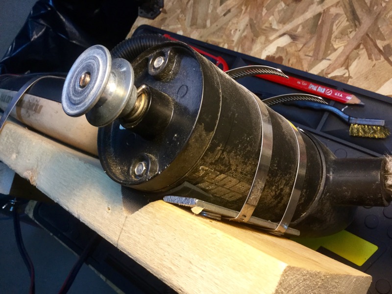

kenbu wrote:Here's the "outboard" setup I use for sanding, finishing and other slow speed work. Reversible, too. It's a small 12v motor, so it's not up to the task of full-time duty.
Wow Ken, please tell me you're not pulling my leg, this is amazing! More pictures of the "outboard" side of the headstock if you can.

Here's some more detail.
Parts list:
  • 1 unused trolling motor, shaft removed
    1.5 in. motor pulley
    6-8 in. driven pulley
    2 x 6 x 22 in. mounting board
    V belt
    3 large hose clamps
    Misc. hardware
    12v DC power source

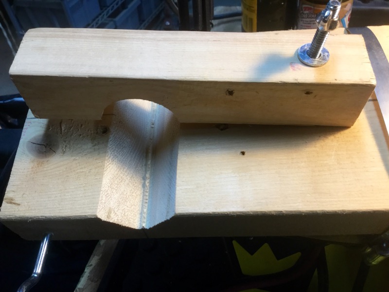

I cut a notch for the motor and used some bar stock to attach the hose clamps to the board, along with a couple of strips of inner tube to resist slippage.
I cut another notch on the underside of the mounting board and made a little clamp to attach to the front way tube. The V belt is short enough that the mounting board does not touch the rear way tube. The weight of the assembly keeps tension on the belt.
Please post pics if you build your own!
Ken

kenbu wrote:Here's some more detail. Please post pics if you build your own! Ken
Thanks for the additional details Ken. I am saving your pictures in a pdf for future reference. Can I bother you for another picture or 2? I would like to see what you're spinning with your old trolling motor. Is it a sanding disk? What woodworking problem did you solve with this most creative use of what you had at hand? I will never look at a trolling motor the same again :)

tomsalwasser wrote:I would like to see what you're spinning with your old trolling motor. Is it a disk sander? What woodworking problem did you solve with this most creative use of what you had at hand?
Like most people who turn on their Shopsmiths, I often want a slower speed -- for sanding or applying finishes -- and the ability to turn in reverse -- again, for sanding or for turning difficult grain. The Powerpro upgrade probably provides much more functionality than my trolling motor, but it's too pricey for me.
