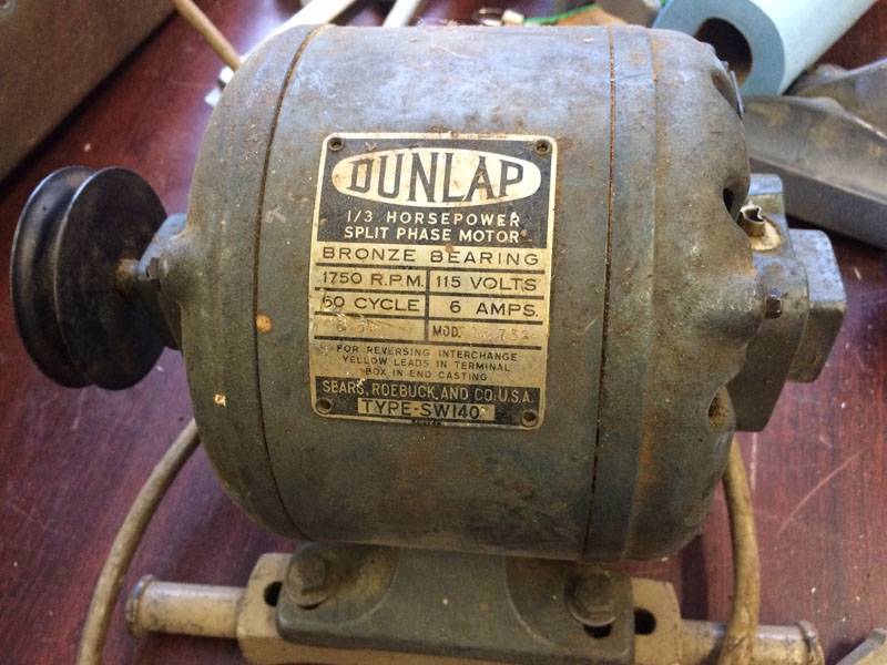

ChrisNeilan wrote:My grinder is a slow speed grinder with CbN wheels. The best setup I've ever used for lathe tools.
Chris I'm just putting together my own slow speed grinder with the help of Bill Mayo and a 1750 rpm motor that came along with my 10E. I was just looking at grinding wheels and the CbN looks amazing. It's pricey, I think I'll get a less expensive one at first to see how my rig works out, then upgrade the wheel later. What grinding wheel would you use if you couldn't use the CbN?
I use the CbN wheels from d-Way tools. They are pricey, but they should outlast me, and they run true with no vibration. They also require no dressing or guards. If I were to go back to a composite wheel, I would use a Norton wheel, probably a white one, somewhere around the 180 grit. Whichever wheel you get, watch the arbor size. You might need an adaptor to fit if. Avoid the cheap plastic ones, they never balance well.
