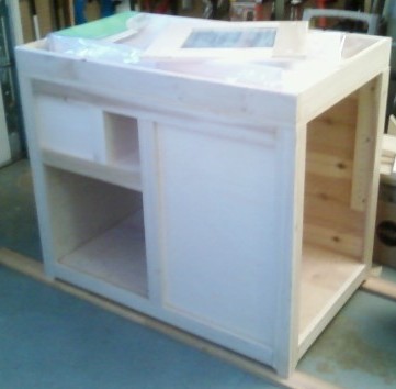

I learned alot about plywood while building my baby's changing table. Baltic birch is the best to work with. I used 3/4" for the top, bottom and basically the entire case construction and 1/4" for outside panels with poplar rails and stiles. (not many people have 120lb changing tables but I figured my sons ass was worth it!!!)
I'm sold on baltic birch. 1/4" is great for templets, especially for repeatabiltiy. 3/4" is great for large/heavy use jigs and furniture. I've always understood that the more plys the better (I've not clicked on the PDF link yet though) I'd be interested about the apple ply and hearing more about it. Here in east central Indiana, baltic birch is about $78/ 4x8 sheet and from what i've seen lately, its not flat-but I believe thats a storage issue on the suppliers part.
