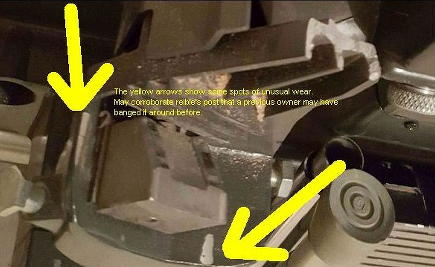

Hmmmm.
Busted Casting.jpg (145.49 KiB) Viewed 1564 times
EDIT: On further review, the mark on the left is something I've seen before.

Yes, it looks like that may have been the case, I don't think he really knew what he was doing. I Noticed in the paperwork that he had ordered the router table and the separate router hood to go with it. I asked him about it and he said that he had thrown the router table away since it was a "useless attachment" :( It very well could be that in the moving process from another state he did bang it around quite a bit. There were two of us moving it and it just gave way on both sides at the same time.

Well the word came back from ShopSmith...
"Our engineer saw these pictures and didn't see any weak casting or porosity. Unfortunately, you never know how something was treated when you buy a unit second-hand. The tie bar casting could have had a crack in the casting when you purchased it. The tie bar casting is item number 514344 with a cost of $ 153.21 plus S&H."
So I guess I'm looking for a beat up 510 table I can steahl the part from!
