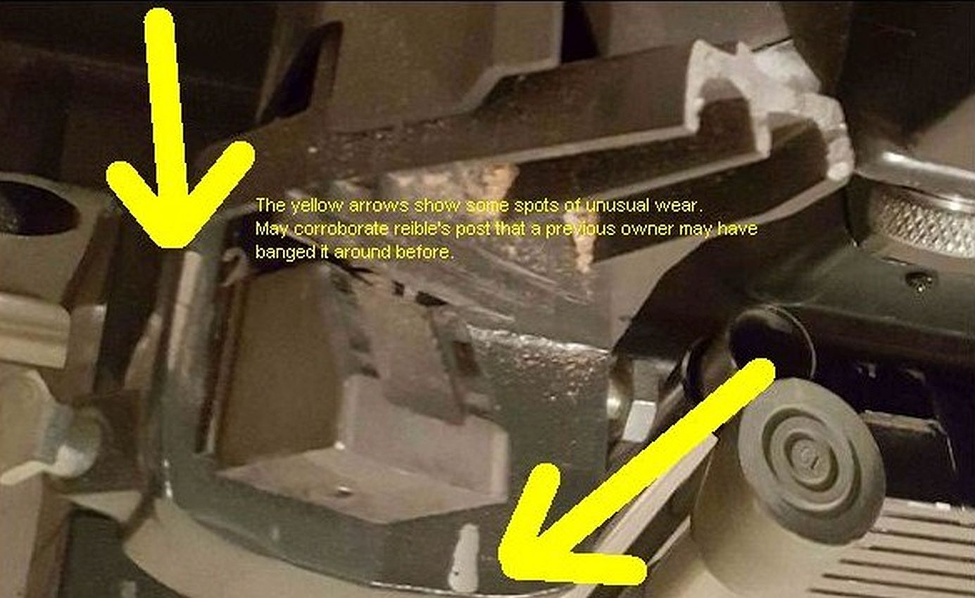

Hmmmm.
Busted Casting.jpg (145.49 KiB) Viewed 1587 times
EDIT: On further review, the mark on the left is something I've seen before.

Yes, it looks like that may have been the case, I don't think he really knew what he was doing. I Noticed in the paperwork that he had ordered the router table and the separate router hood to go with it. I asked him about it and he said that he had thrown the router table away since it was a "useless attachment" :( It very well could be that in the moving process from another state he did bang it around quite a bit. There were two of us moving it and it just gave way on both sides at the same time.

I think you should count yourself very lucky that you moved it by the table, causing it to break when it did. As fragile as it apparently was, it may well have broken while sawing a large piece of wood. :eek: And that would be a very dangerous thing indeed.

I've never moved mine around by using the main table however, I just can't imagine it causing the casting to break. I'd bet the table had a fracture in the casting from a previous incident and just happen to let go on you..
Thank goodness you weren't running the table saw and have it snap off!

Well the word came back from ShopSmith...
"Our engineer saw these pictures and didn't see any weak casting or porosity. Unfortunately, you never know how something was treated when you buy a unit second-hand. The tie bar casting could have had a crack in the casting when you purchased it. The tie bar casting is item number 514344 with a cost of $ 153.21 plus S&H."
