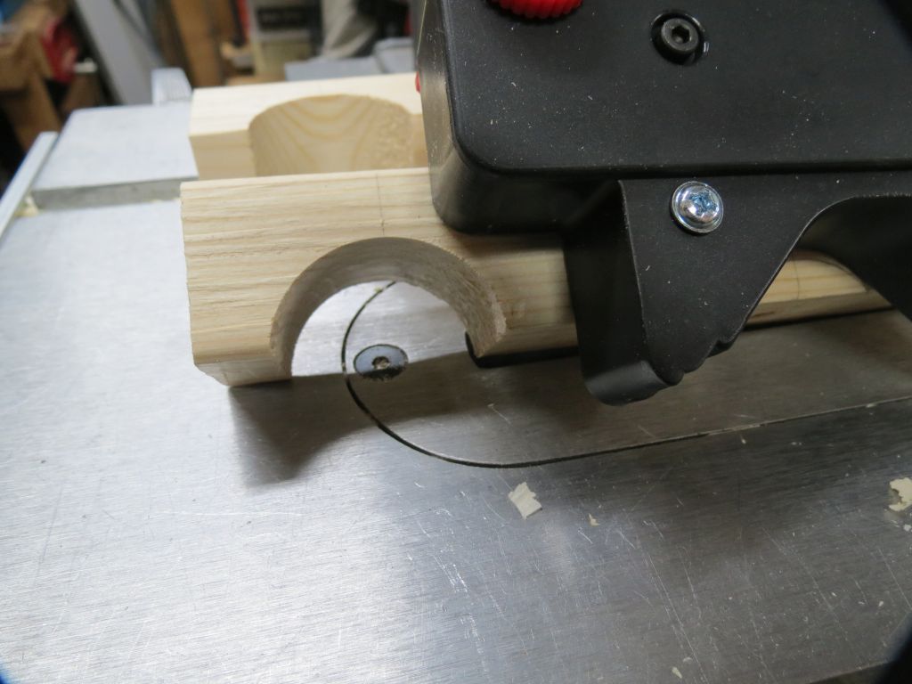

Posted: Wed Jan 27, 2016 12:41 pm
by reible
There is no need to cut the housing and if one were to adapt this another way you could even avoid the two holes I drilled but it just seemed so simple to drill them and mount that way........ The design is for a single column drill press and in that case they use a hose type clamp to hold it in place.
The drill press column would normally be where this green circle shows.
The two hole were for these two screws:

In this picture it looks like you would have to cut off corners of the holder to clear the way tubes.
Is that what you did or is it just a perspective problem with this picture?

reible wrote:There is no need to cut the housing and if one were to adapt this another way you could even avoid the two holes I drilled but it just seemed so simple to drill them and mount that way........ The design is for a single column drill press and in that case they use a hose type clamp to hold it in place.
Ed in Tampa wrote:
The corners I was talking about are the ones on the holder to the right and left of the green arrow. From the picture they appear to infiltrate the holes for the way tubes.

OK how about another picture.
This should clear thing up, right?
[/quote]
The corners I was talking about are the ones on the holder to the right and left of the green arrow. From the picture they appear to infiltrate the holes for the way tubes.[/quote]
Re: Today in the Shop (Lasers in the shop some where)
Posted: Wed Jan 27, 2016 5:55 pm
by Ed in Tampa
reible wrote:OK how about another picture.
That is more better :D It was just the sight perspective on the other picture. :eek:

by reible
Most often more better is better so glad to provide a picture of the area in question. Again it is nothing fancy but it appears functional.
