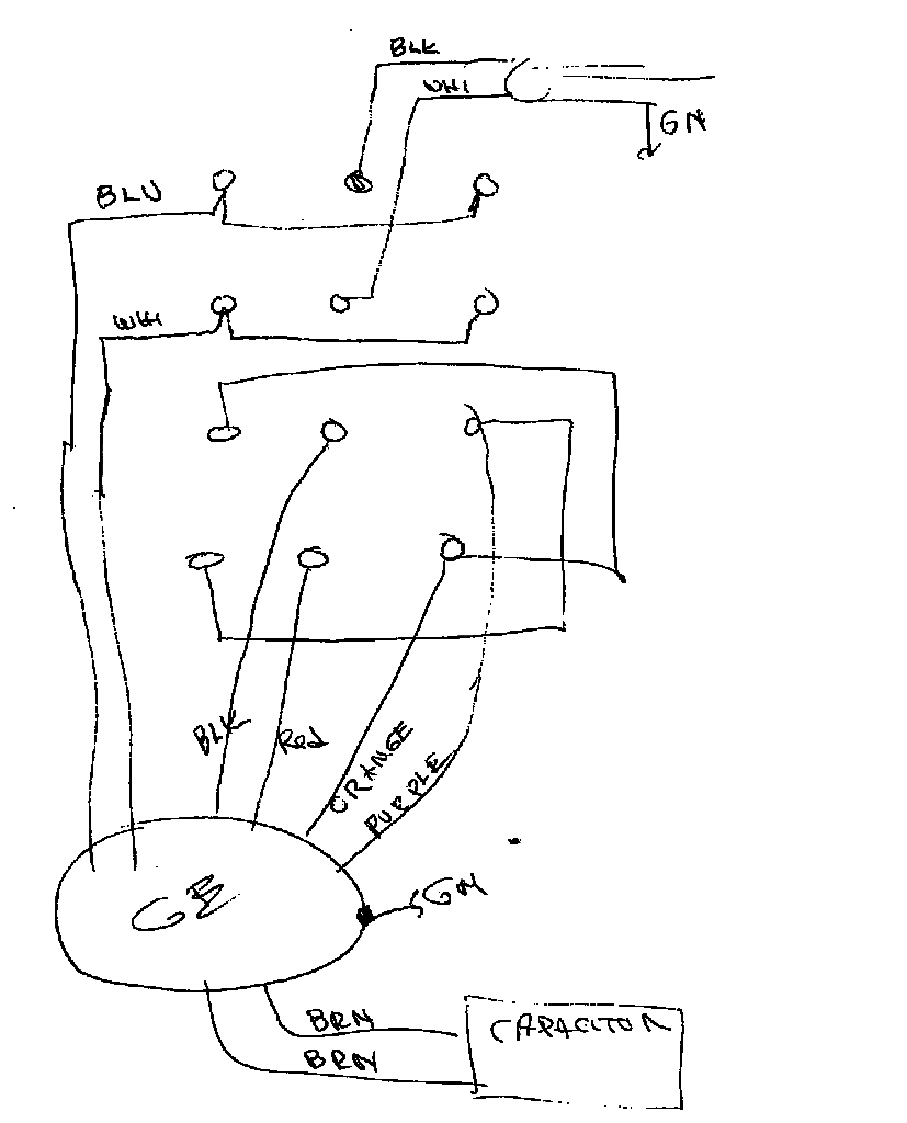

Ah ha indeed!!!! The manual copy I sent him is indeed like he showed.
I do think it is indeed incorrect.
There is no way the motor will run with a capacitor in series with the entire motor.
So my apologies to thee Everett. I did not realize the manual version I sent to you was incorrect. It was from a 1965 vintage manual(pdf). that I got online when I had misplaced mine. My hardcopy(now found) is a 1966 version which I assume is a corrected version.
When I get a chance, I will scan the hardcopy and send that to you as well.
The GE motor drawings are also different. The red and black wires(T9 T5) are reversed in the two versions. I venture to say that the 'sent' version is likely incorrect(the motor will have forward/reverse bass akwards.
Finally here is the third version mentioned earlier. An A. O. Smith motor with an external start relay(similar to early GE 3/4hp motors).
I think this provides a clue as to where the "2" and "5" terminal labels came from. They refer to the start relay terminals to which they connect. It also implies it was the first motor used for a Mark VII.
I scribbled in the start relay contact and coil terminations.
Oh, and the 'tracer' is spiral.

I wired like you showed me motor works both ways.
IM thinking my switch is bad so i going to hook it back to the two toggle switchs until i can get it fix. any Ideas how to wire ? i have 1 two pole
and 1 four pole switchs 20 amp.

4 pole switch needs to be double throw with center off.hobbies wrote:I wired like you showed me motor works both ways.
I did not remember this 'sketch' was for a GE motor. Will add one for an AOSmith later.

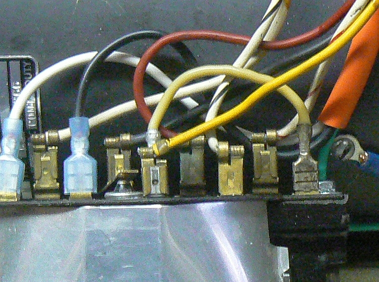

This photo is excellent for showing the wire colors.
