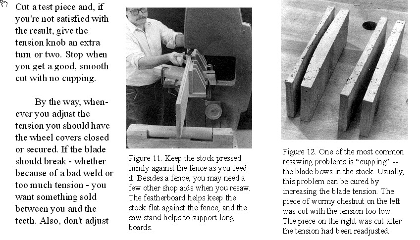

A question regarding 'cupping'.
I assume cupping is a tendency for the blade to deviate from vertical as it transverses through the workpiece. Thus it creates a concave surface on one half of the resultant pieces and a convex surface on the other.
My question is, relevant to the previous statement regarding adjusting for cupping left/right which half(concave/convex) is 'the direction of cupping'?
The concave side(i.e. the blade deviates towards that 'half' in the center)?
In Nick's shop tip included in Sawmill's thread cupping was pictured as a curve along the TOP???????
http://www.woodshoptips.com/tips/011303/011303pt2.pdf
bandsaw cupping.jpg (226.39 KiB) Viewed 2178 times
Anyone else notice the 'guardless' bandsaw? :D

Thee thinks the guard is raised to permit the resawing.
Re: Band Saw Frustration And Seeking Blade Recommendati
ERLover wrote:Thee thinks the guard is raised to permit the resawing.
Methinks the missing guard belongs below the table! :D
