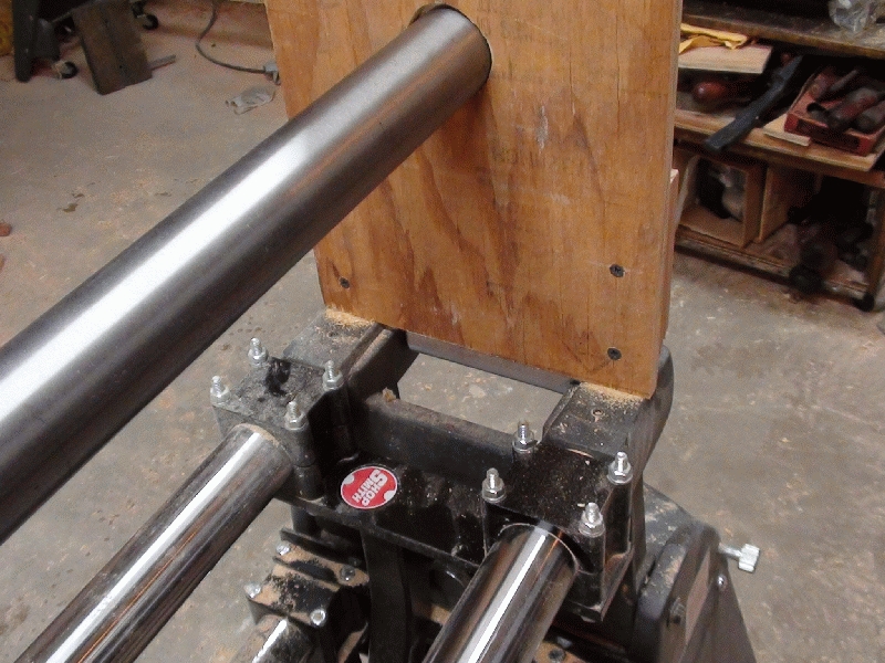

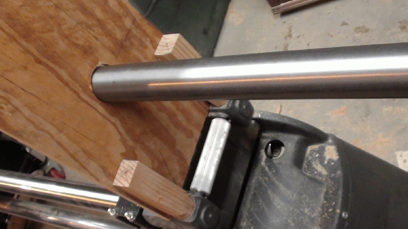

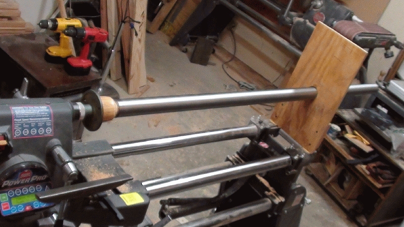

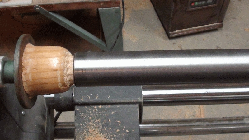

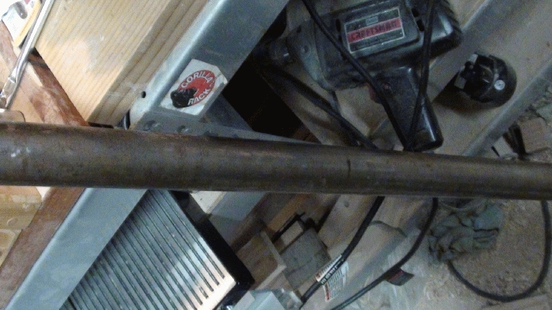

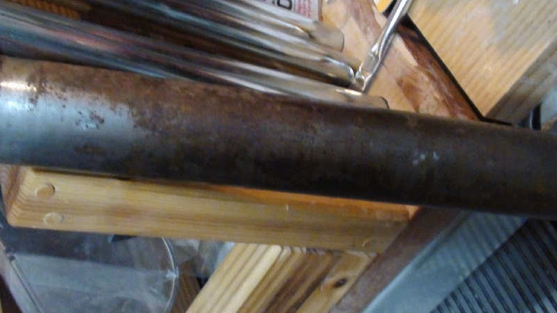

OK, first way tube is done and waxed:
Before:
Way tube finish 07.jpg (298.71 KiB) Viewed 8537 times
Way tube finish 08.jpg (312.12 KiB) Viewed 8537 times

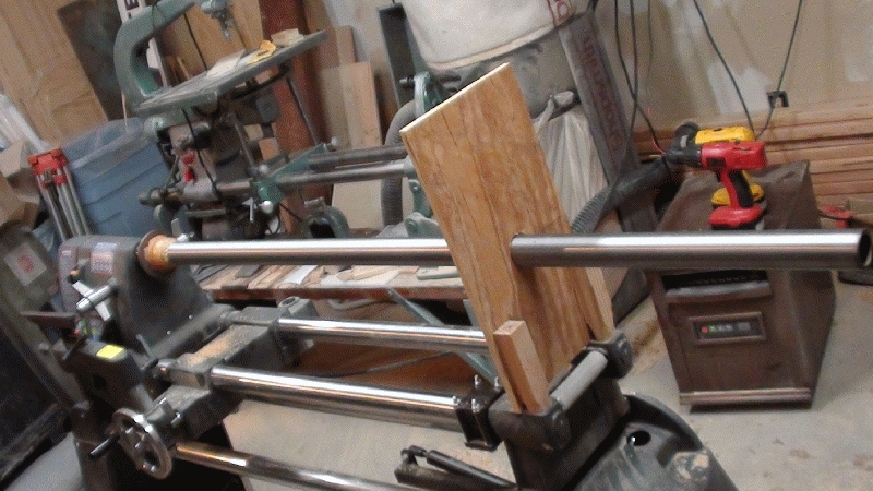

Farmer engineering: :D
Way tube finish 01.jpg (323.24 KiB) Viewed 8537 times
Way tube finish 02.jpg (324.35 KiB) Viewed 8537 times
Way tube finish 03.jpg (286.46 KiB) Viewed 8537 times
Way tube finish 06.jpg (407.38 KiB) Viewed 8537 times
Way tube finish 09.jpg (321.69 KiB) Viewed 8537 times

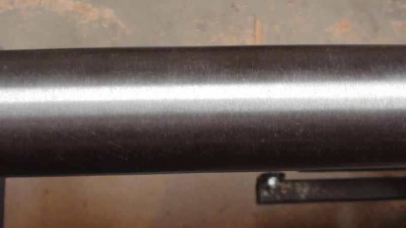

Finish:
Way tube finish 04.jpg (285.87 KiB) Viewed 8537 times
Way tube finish 05.jpg (249.34 KiB) Viewed 8537 times
I had to take about 3 to 4 thousands off (according to the digital calipers), so I should be good to go. Do the other one tomorrow (maybe, have possible snow coming in :( )

Kinda like the tail stock :rolleyes: I used 2 castors, but should of used 3, I fretted seeing my dentist, if it went a flying.

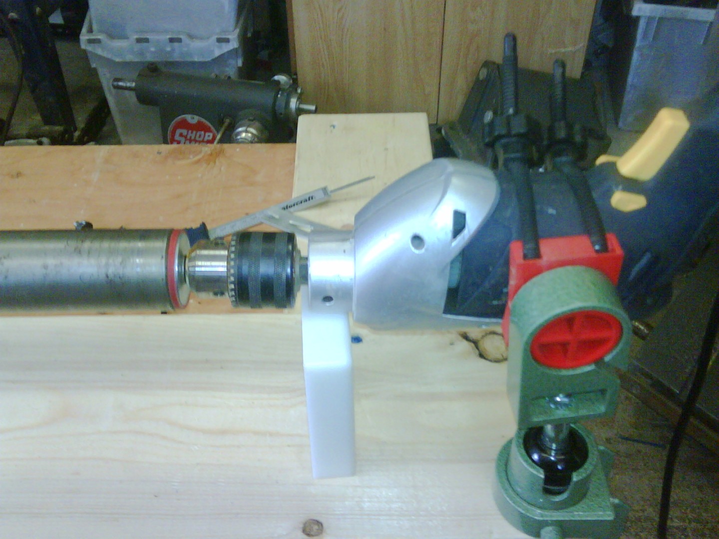

Woot, a treasure trove of tools. :cool:
That set up did a great job on the way tubes.

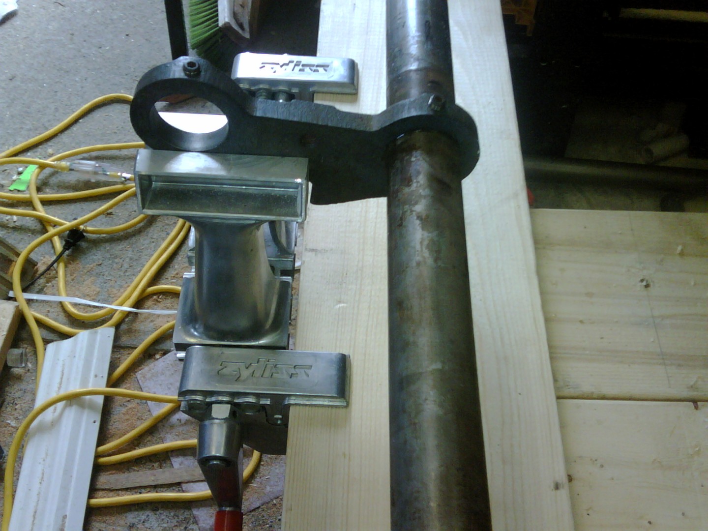

When I did mine I used the tie bar,(the cast iron and a bit of oil made a good bearing), clamped in a Zyliss vise at one end of the bench, and an electric drill and expansion plug at the other.
However I didn't have a working Shopsmith at the time. ;)
edit Found pictures of my setup

rpd wrote:Woot, a treasure trove of tools. :cool:
I hear you, this is the second time I have used this rig on the Mark 7. I run it at the 250 RPM speed which helps. It has worked perfectly again so far. I may have to make a "muzzle" on the free end to give the quill something to push against (had to do that the last time), but so far my "plug" is working like I knew what i was doing .... :D

How do you get it down to 250rpm, a speed reducer? I was doing mine on a greenie at bottom rpm 700ish, and sweating my front teeth.
Looked back at your pics, I see said the blind man, after removing his dark glasses :o On a PP :eek:

Excellent job!!!!! I love the simplicity of your polishing rig..........
