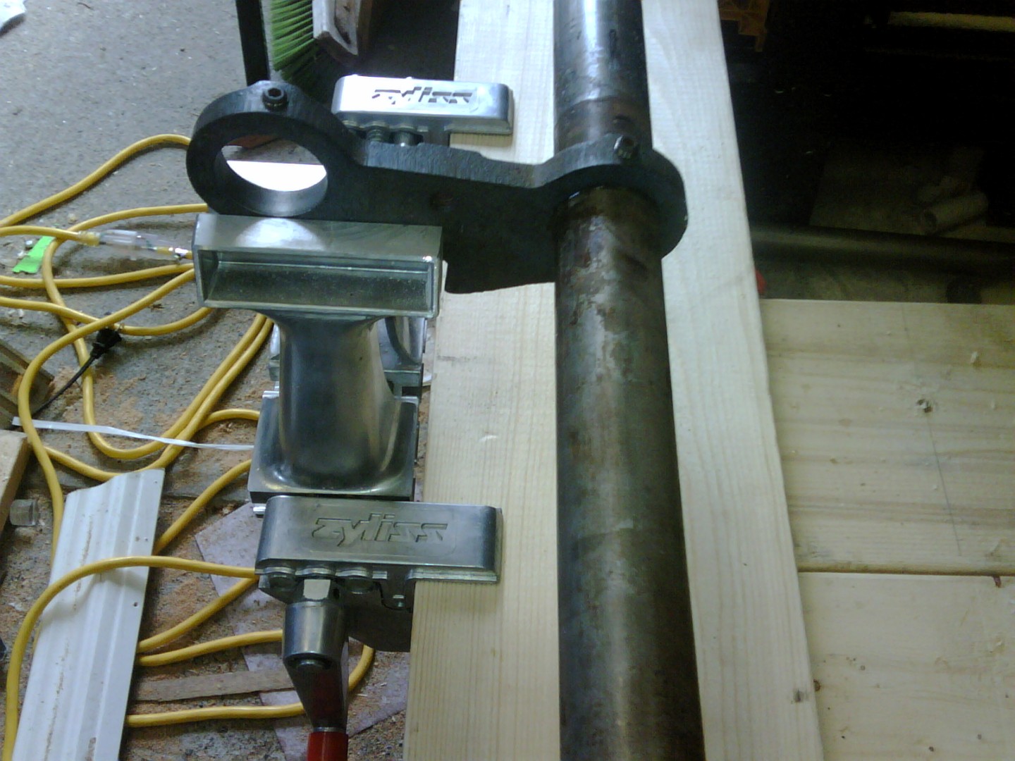

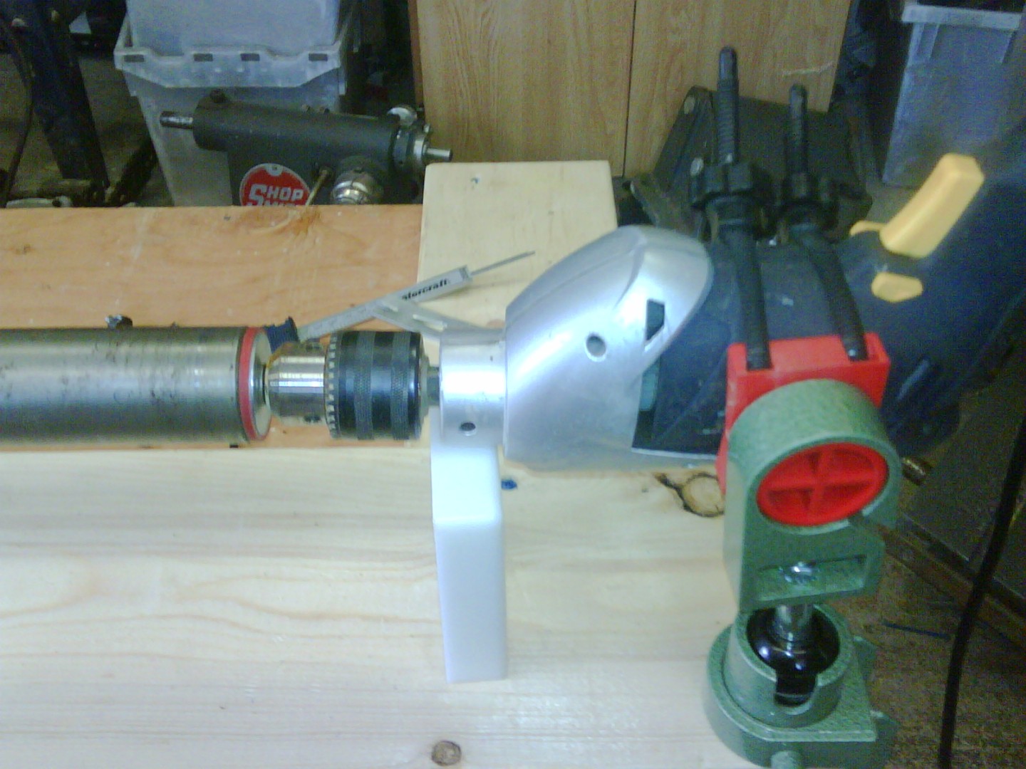

When I did mine I used the tie bar,(the cast iron and a bit of oil made a good bearing), clamped in a Zyliss vise at one end of the bench, and an electric drill and expansion plug at the other.
However I didn't have a working Shopsmith at the time. ;)
edit Found pictures of my setup
drill end.jpg (270.14 KiB) Viewed 8332 times

rpd wrote:Woot, a treasure trove of tools. :cool:
That set up did a great job on the way tubes.
I hear you, this is the second time I have used this rig on the Mark 7. I run it at the 250 RPM speed which helps. It has worked perfectly again so far. I may have to make a "muzzle" on the free end to give the quill something to push against (had to do that the last time), but so far my "plug" is working like I knew what i was doing .... :D
