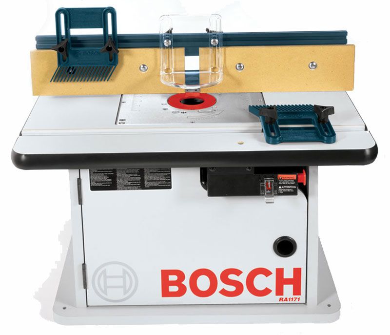

The table I want to put it in looks like this except it is an older version sold with craftsman label.
older version of this sold as craftsman.jpg (53.53 KiB) Viewed 16142 times
The mounting plate is only 7" x 8" so I'm limited on how much I can move things around but it good to know you are managing with it mounted at an angle. Once it warms up in the shop a bit I will have more sense of how this will have to come together. For now I hope to re-drill the existing table insert to fit the mounting holes. I have a set of three reducer inserts that fit that plate but no way to mount guide bushings......... so I think I'm OK with that for now anyway.

I have a similar Craftsman/Bosch router table, but with an aluminum table and plastic legs. The fence looks almost identical to yours. On that table, I relocated the switch to the side, so that the front is completely open for easy access to the router. (An old Craftsman plunge router.) My stand-alone OPR, of course, has an open front by design.
