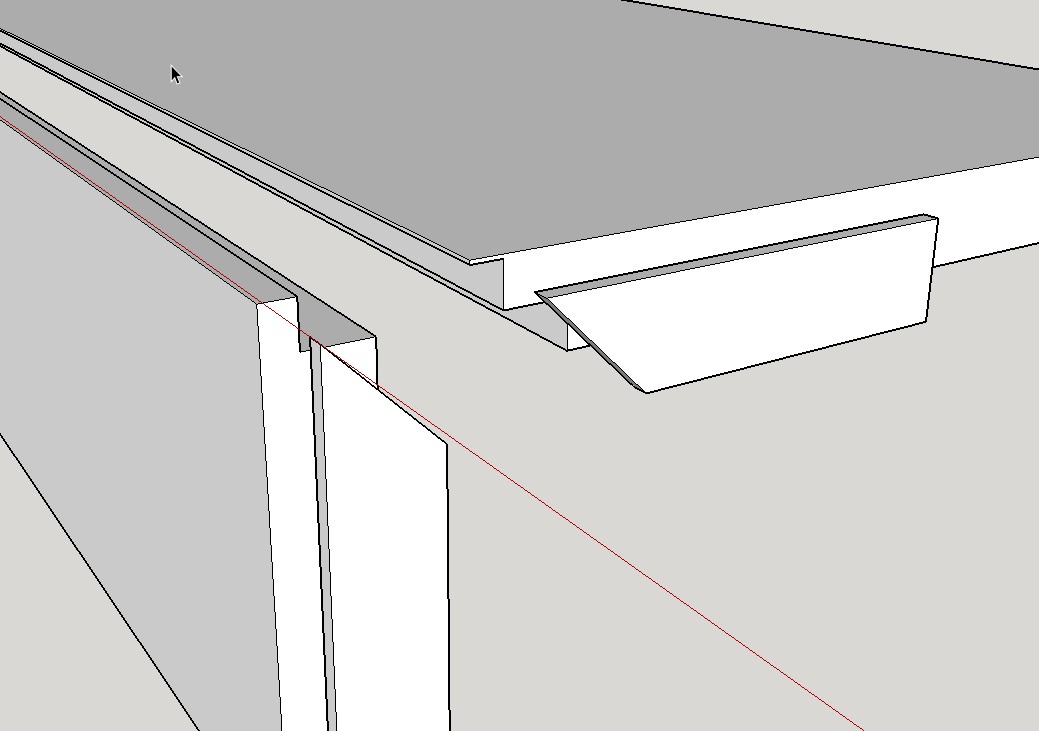

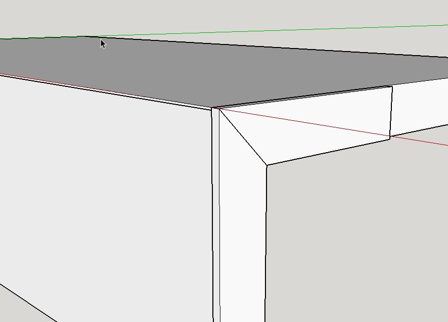

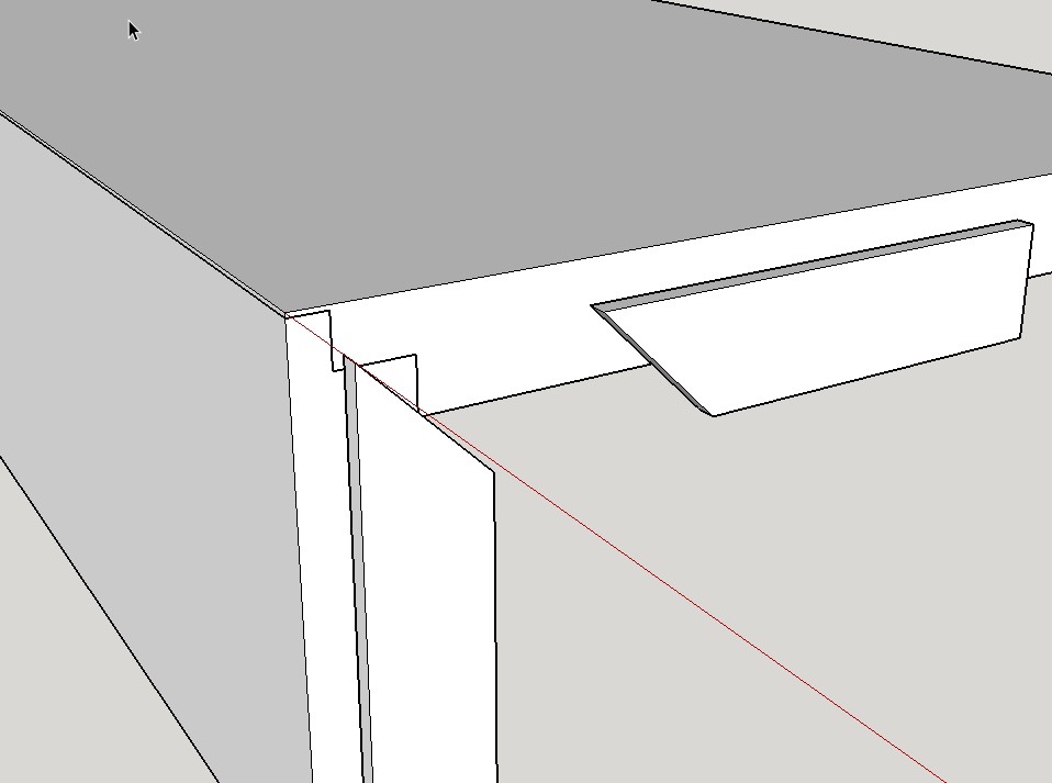

I'll do a sketch of the joint of which I speak a little later tonight and post so you can see what it looks like. I think you will like it and so will she.......... well maybe anyway.
Re: Build Dilemma
Cut a narrow strip off each front edge, miter them and glue back on.
Re: Build Dilemma
Hope this makes the joint clear enough to understand.
