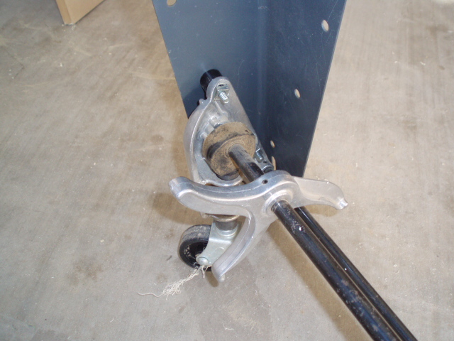

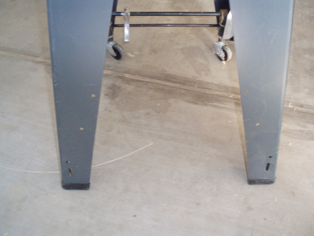

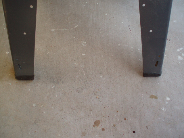

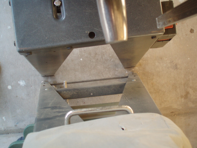

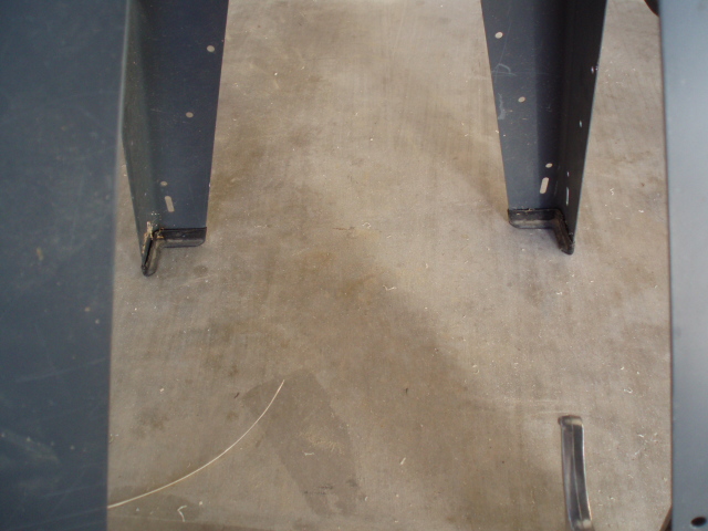

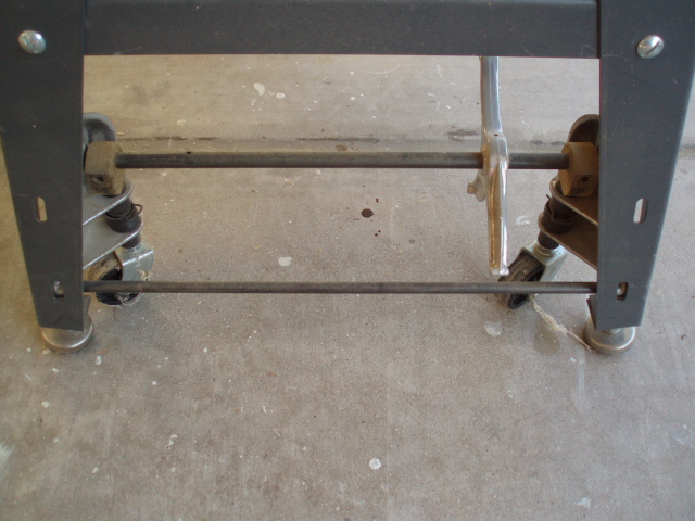

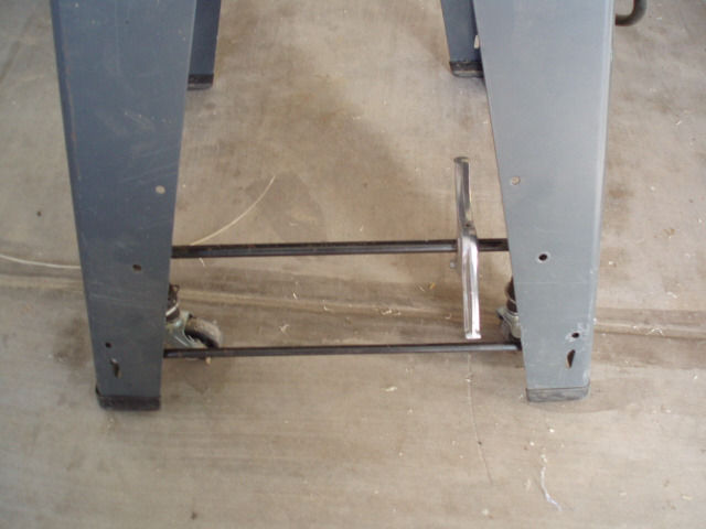

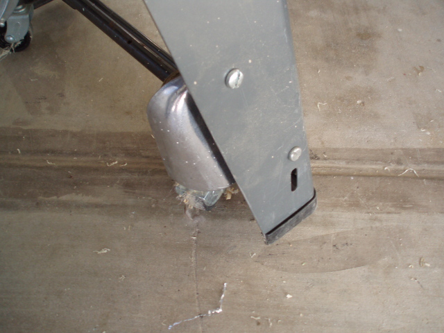

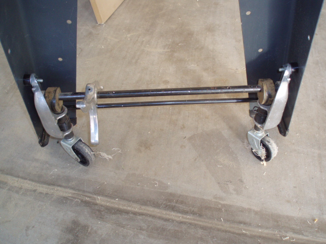

I hope these help/ Not knowing exactly what your problem was - I took ten shots. One is a kludge arrangement that was done so that I could mount casters on the scroll saw which has different legs than the power station.
[ATTACH]3241[/ATTACH]
[ATTACH]3242[/ATTACH]
[ATTACH]3243[/ATTACH]
[ATTACH]3244[/ATTACH]
[ATTACH]3245[/ATTACH]
Kludge on Scroll Saw.JPG (157.51 KiB) Viewed 11317 times
Power Stand No Casters.JPG (153.21 KiB) Viewed 11305 times
Span Comparison Scroll Saw and Power Stand.JPG (146.25 KiB) Viewed 11303 times
With an d Without Casters 2.JPG (142.02 KiB) Viewed 11307 times
With and Without Casters.JPG (144.18 KiB) Viewed 11308 times
Shopsmith Retractable Casters
[attach]3246[/attach]
[attach]3247[/attach]
[attach]3248[/attach]
[attach]3249[/attach]
[attach]3250[/attach]
After posting I realized that I had shuffled pictures around and might create some confusion. The photos are of a standard power stand and of the scroll saw stand. The scroll saw has legs that are narrower at the floor than are the legs on the power stand.
If you look close, you will see that each of the stands has a pair of legs with wheels and a pair without. I decided, while doing these photos, to take the casters off the scroll and install them on the Power Stand. In my new shop configuration I hardly ever need to move the scroll saw and the Power Stand (for the Belt Sander) gets moved frequently. I try to get near the doorway with the sander (outside if possible).

Dusty,
Thanks a bunch for the pics. They help a lot.
