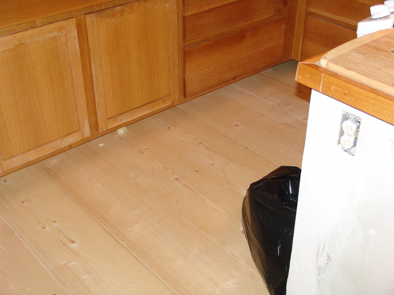

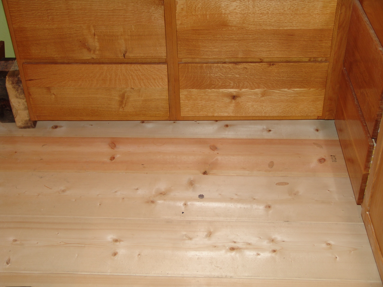

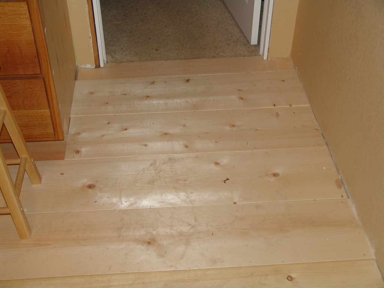

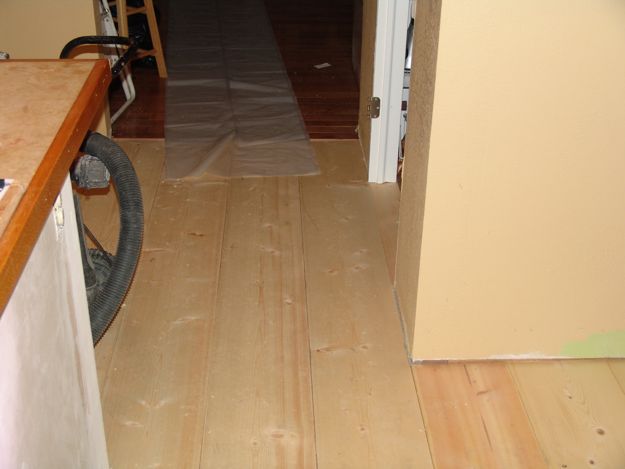

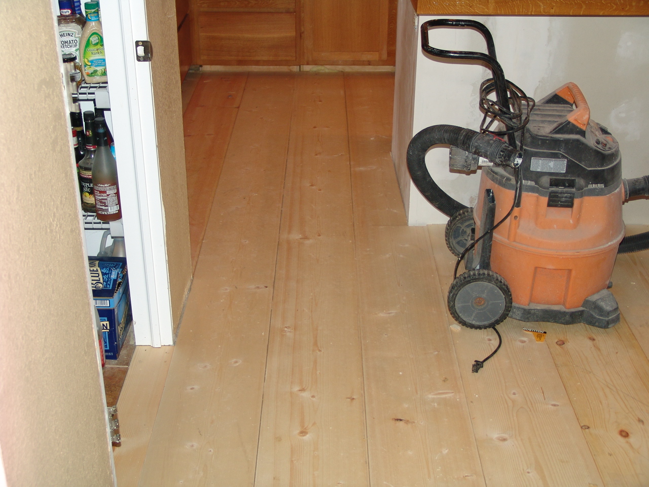

Tom, that's gonna look great! But I'm curious .. with boards that wide, is expansion/contraction a concern?
- TomHoffman
- Posts: 63
- Joined: Sat Feb 06, 2016 1:09 pm
- Location: Iowa
Re: Wood Floor for Kitchen
Yes, I am sure you are right. In Iowa we have very dry houses in the winter and High humidity in the summer. I am sure there will be movement, we are face nailing 4 nails across the board so a board may crack, and if so it's just more character. The boards are all cut along each side with a spine cutter router bit that fits a #20 biscuit. the biscuits are every foot or so. Try as we might we ended up with between a 1/16 - 1/8" between some boards because of some slight bowing in a board or 3. That will allow for some wood swelling in the summers and back to original installation (now) width in the winter.BuckeyeDennis wrote:Tom, that's gonna look great! But I'm curious .. with boards that wide, is expansion/contraction a concern?
