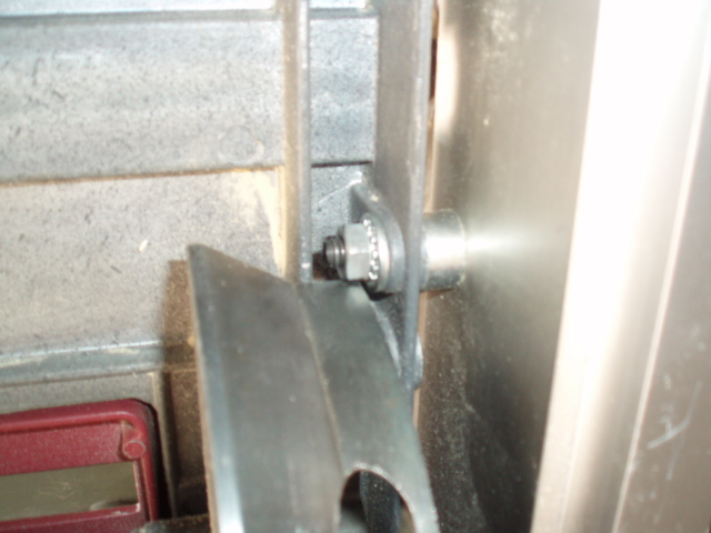

Now that I have done it, I'm not sure it was worth the effort. The movement of the trunnion is restricted by a nut on the center bolt that holds the rear rail on the main table.

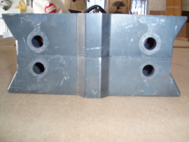

I also discovered that someone else (Shopsmith) has had this same problem. Looking at the photo of the the two trunnions, you can see that one of them has had some millwork done right where the mounting nut would touch the trunnion. [Left side/Top Trunnion/First Photo]
- Same Size Holes.JPG (129.18 KiB) Viewed 4068 times
- Interference Fit.JPG (131.43 KiB) Viewed 4065 times

Much, much to my surprise, aligning the main table can be made easier than it already is if the holes in your rear trunnion are 3/8" in diameter. By drilling out those two holes to 1/2", the main table can be moved around more making alignment much easier.
The procedures that Rick and Nick present in the Shopsmith Journal and in the Sawdust Session always worked but with this increased mobility of the table (on the trunnions) it is really slick.

I also took a file to the one corner of the rear trunnion to eliminate the interference between the trunnion and the nut that secures the center mounting bolt in the rear rail.
