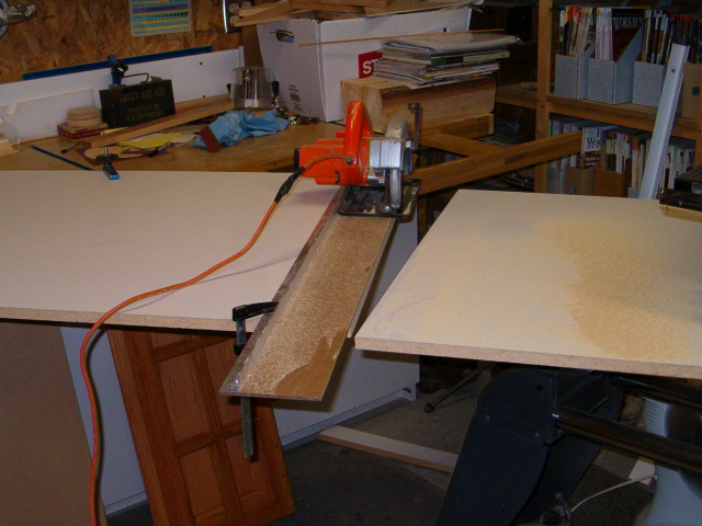

One day, if the situation would ever arrive, I would like to compare the edge of a cut for straightness and smoothness produced by a Festool and their straight edge with one made by my homemade saw guide and my circle saw which I bought at a pawn shop for $25.
My cost was approximately $35 for the whole thing.
straight edge - circle saw.jpg (118.86 KiB) Viewed 1808 times

charlese wrote:My Goodness!
At those prices you could add a couple hundred and by a PowerPro DIY kit.
Both the keeper side and the waste side have no tear out with the Festool. Plus you get about 96% dust collection, soft start, plunge cut and riving knife. Depth of cut is very easy to set as is bevel. Plus the blade does not move when to swing it over to bevel you can use the same straight edge for both straight or bevel cuts. Plus the motor technology is similar to the Shopsmith power pro DVR type. Blade change is simplified and you get an easy replace plug/cord.
Quite honestly this is about the same argument I have with the power pro upgrade. If it makes sense to you, you buy it if not you say it way too expensive.

Got to admit the Festool stuff doesn't make sense to me, but my original post was intended only as a price shocker. However if a guy wants one he should get one. Some people evidently do purchase these things. After all the Festool Co. is still in business.
I'll be willing to bet (no $) that the great majority of Festool purchasers are in business and can write off the depreciation. Usually a 5 year period. If the Festool features of the $1400 value spread over 5 years, or $280 per year, are acceptable to the business then it is a good deal.
