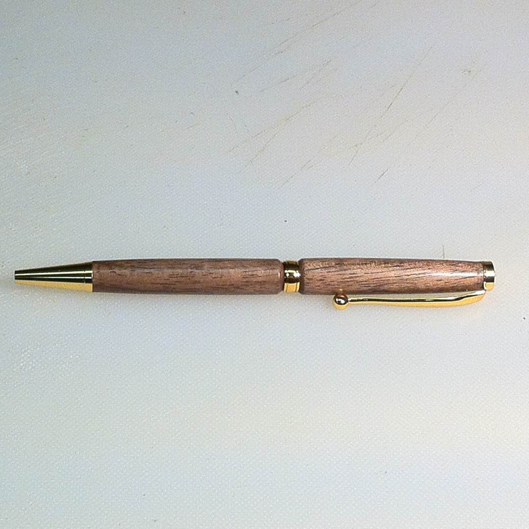

Posted: Sun May 01, 2016 2:04 am
by rpd
So far I have only done CA finish on pens, very hard and durable but it does feel like plastic.
This evening I turned a pen to give for a raffle prize at an event we will be attending tomorrow. (slimline pen kit, walnut) and decided to try a different finish, Watco Oil. I put on about five coats, rubbing it in with a blue paper shop towel between coats and finishing with a coat of Watco Satin Wax.
twist pen walnut watco oil.JPG (242.93 KiB) Viewed 12551 times
This is also the first pen I have turned using walnut, a wood I am particularly fond of. :cool:
I am very pleased with how it turned out, looks nice and feels good in the hand.
