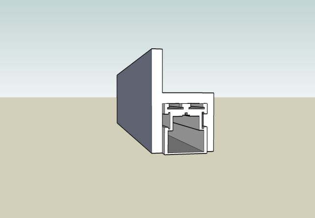

Paul, would something like this work?
I would expect that it would have to be secured to the fence using t-nuts. The vertical could be sized to whatever your needs are. It can be used on either side of the rip fence.

dusty wrote:Paul, would something like this work?
Yes, Dusty, that is a rather good suggestion. Thanks.
That will work great as long as you do knot need one of the "T" slots.

Dusty's suggestion looked perfect. I seem to remember something similar that was fairly tall and hand 45 degree angled supports to keep taller boards square. fjimp
