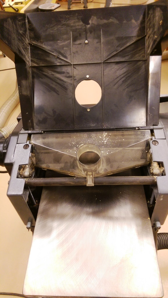

I can't believe none of you guys know what this is about. SS has offered a dust collector for the planer for years. It works very well but it does not get everything because of the way a planer cuts. Am I missing something?

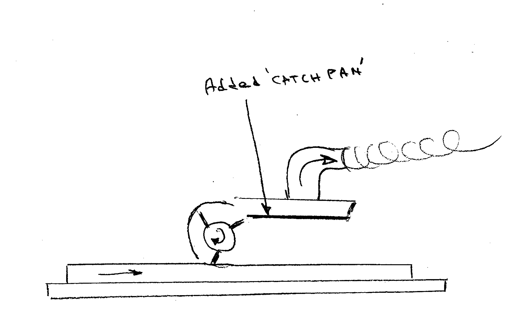

Your clear plastic dust collector has a sheet-metal baffle installed on the underside. That piece is a newer improvement, and greatly increases chip-collection efficiency. Older models of the dust chute did not have it. My used planer came with the dust chute, but not that baffle. I bought the upgrade from the mothership and installed it, to excellent effect.jsburger wrote:I can't believe none of you guys know what this is about. SS has offered a dust collector for the planer for years. It works very well but it does not get everything because of the way a planer cuts. Am I missing something?

OK, I understand now.BuckeyeDennis wrote:Your clear plastic dust collector has a sheet-metal baffle installed on the underside. That piece is a newer improvement, and greatly increases chip-collection efficiency. Older models of the dust chute did not have it. My used planer came with the dust chute, but not that baffle. I bought the upgrade from the mothership and installed it, to excellent effect.jsburger wrote:I can't believe none of you guys know what this is about. SS has offered a dust collector for the planer for years. It works very well but it does not get everything because of the way a planer cuts. Am I missing something?

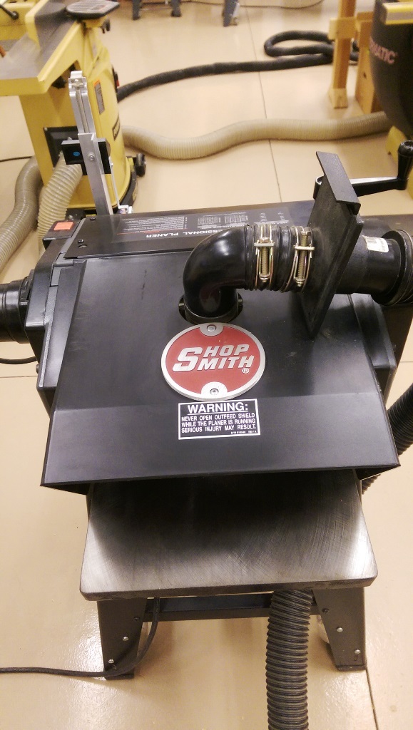

I have a part that snaps into the metal bars in the planer and exits out the logo hole in the top on the out feed side hood. I have had it since I bought my original planer. It is from the mother ship. This thing together with my Harbor freight 2HP dust collector leaves almost nothing behind. It does a great job of dust collection.
