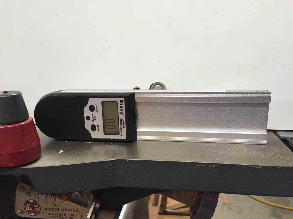

And by all means one needs to check the digital protractor for accuracy. I have checked mine several times and it is dead on. I just put it on the jointer table and press the calibrate button before I check it. It's magnetic so both ends stick to the table which makes it easy to zero.

Just took a picture.
- image.jpeg (133.88 KiB) Viewed 5598 times
