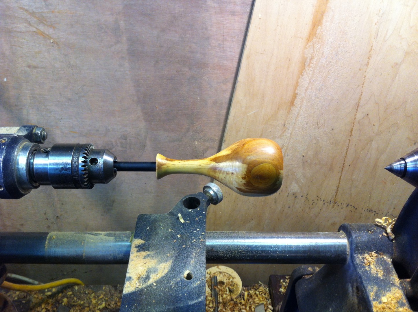

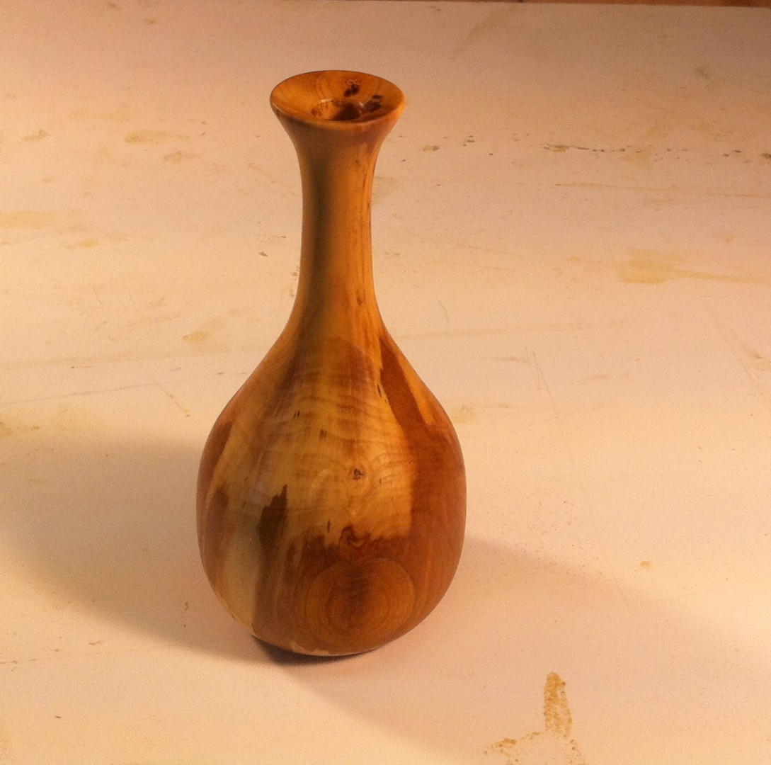

Today I needed to turn a twig/weed pot (only my third) on short notice (less than two hours) for a birthday present for a friend.
twig pot 3.JPG (188.38 KiB) Viewed 5084 times
When I did the first two I used a hand chisel to pare off the nub on the bottom and then hand sanded that bit. :( There had to be a better way.
So for this one I found a transfer punch that just fit the hole in the top, snug fit. Chucked the transfer punch in the drill chuck and instant jam chuck. :cool:
transfer punch - jam chuck.JPG (373.84 KiB) Viewed 5084 times
Worked like a charm. :D Turned off the nub, sanded and finished the bottom in no time.
Branch (apple wood, cut last year) to finished pot in 1 1/2 hours. Recipient was very pleased.

Great thinking, Ron! :D The punch beats the dickens out of using a chuck. A chuck would leave marks.

I like the mini vase! I have some cut up apple wood branch but I didn't leave any longer pieces.... darn.
So is it hollowed or just a hole?
If it is hollowed I'm not sure how it stays stable, so looking forward to more information.

reible wrote:I like the mini vase! I have some cut up apple wood branch but I didn't leave any longer pieces.... darn. You only need 4 or 5 inches.
So is it hollowed or just a hole? Just a hole, I have been doing 3/8" about 3" deep. I think somewhere between 1/4 and 1/2 should work.
If it is hollowed I'm not sure how it stays stable, so looking forward to more information. The first one has developed a small crack in the neck.
