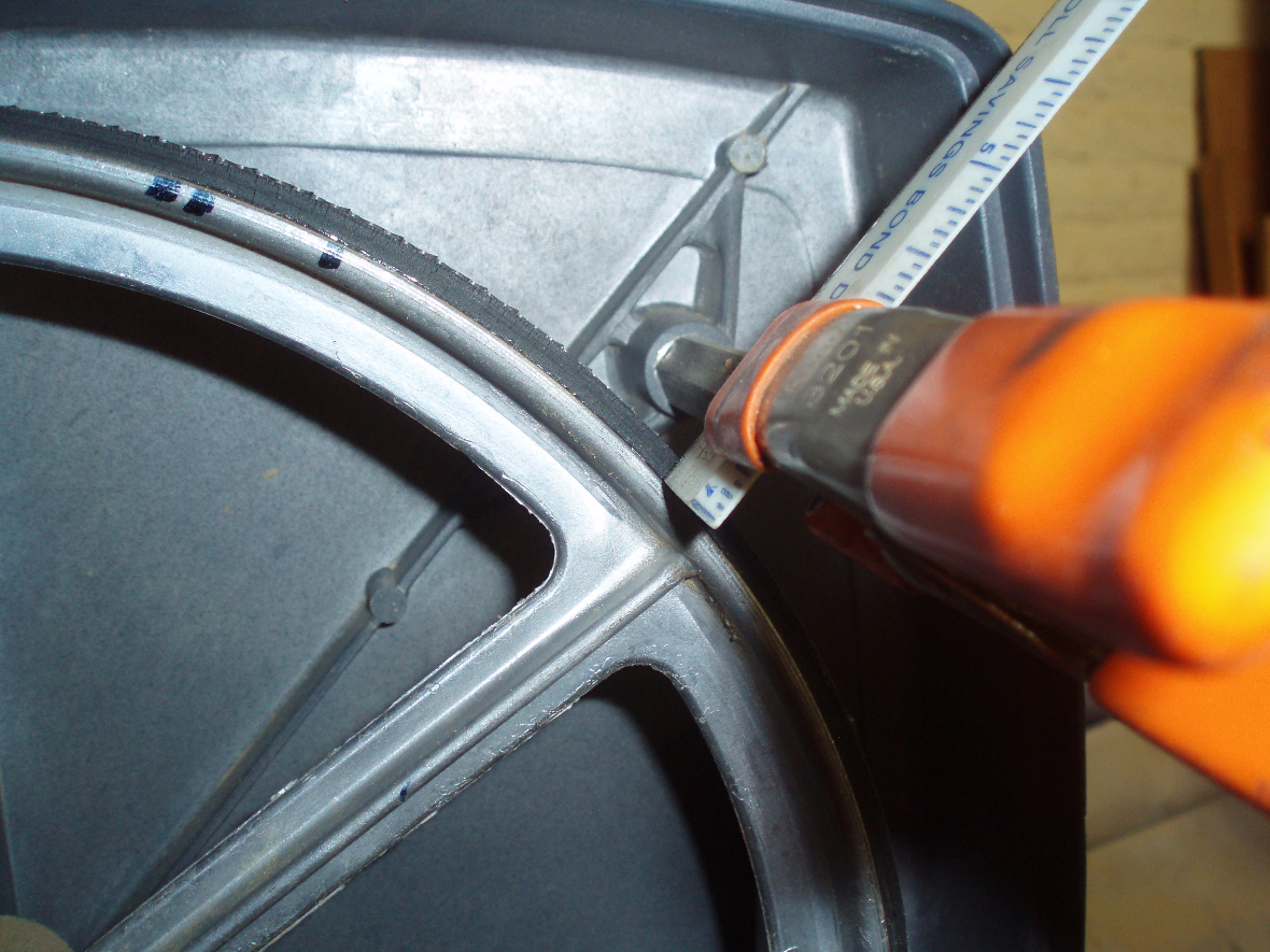

band saw wheel wobble 003.JPG (1.38 MiB) Viewed 1915 times
This photo image displays the upper wheel but the same thing can be done on the lower wheel. It provides a real good visual of what the wheel is doing as you rotate it by hand.
You can check the wheel for an "out-of-round" condition at the same time.

reible wrote:My wife is wrapping a package to drop off at the post office so I took a few minutes to do the video.
https://youtu.be/ce16RZdjDUQ
I could do a better job but you should get an idea of what mine looks like. Sorry about the other movements.... needed at least 3 hands for this.
I do not believe this is a way to determine wheel wobble. The wheels are cast. The face of the wheel is not machined so it is not a reference surface. As long as the outer machined rim (diameter) where the tire is installed and the bearing bore are concentric it doesn't matter what the rest of the wheel is doing. There is no wobble. Now if there has been warping of the wheel after manufacture or a bad bearing then that would cause wobble. But again the edges of the rim are not an indication of wobble since they are not machined to be 90* to the bearing bore.
Re: Wobble in Lower Bandsaw Tire
I tend to disagree. A reference surface would be essential if we were checking for thousandths of an inch movement (wobble) but that is not the case. We are seeing something more like a 1/16" movement.
dusty wrote:I tend to disagree. A reference surface would be essential if we were checking for thousandths of an inch movement (wobble) but that is not the case. We are seeing something more like a 1/16" movement.
Well, I also disagree. Look at the video in full screen with your best glasses. There are a lot of reflections and light issues. The tire is not pushed back against the flange nor is it parallel with the other edge of the wheel all of which produces an optical illusion that makes one think there is wobble. If you concentrate on the actual edge of the wheel and not the light reflections on the rule and the wheel there is very little movement. Probably less than 1/32".
Look at Ed's video. Almost no reflections on the wheel and a black rule.
I stand by my statement. Besides it is a new wheel from the MS.
