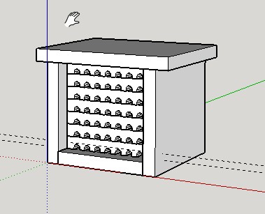

The basic design is looking like this:
ScreenHunter_107 Mar. 09 22.13.jpg (23.21 KiB) Viewed 14127 times
I've seen the holes the other way round too so if you like that better you simply make it that way.

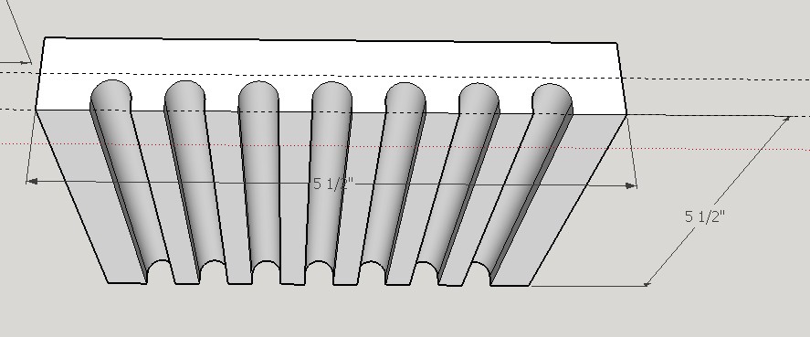

Each of the racks looks like this:
ScreenHunter_106 Mar. 09 22.12.jpg (50.69 KiB) Viewed 14127 times

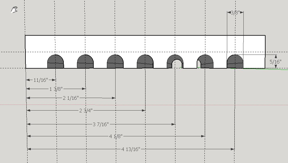

As I mentioned before I'm going for a seven high arrangement but if you want to make more or less again it isn't a problem but you will have to size the box to fit.
Here is an idea of the dimensions for the rack. Don't fret it is easier to do then it might look.
ScreenHunter_108 Mar. 09 22.19.jpg (53.72 KiB) Viewed 14127 times

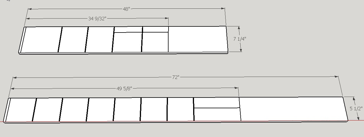

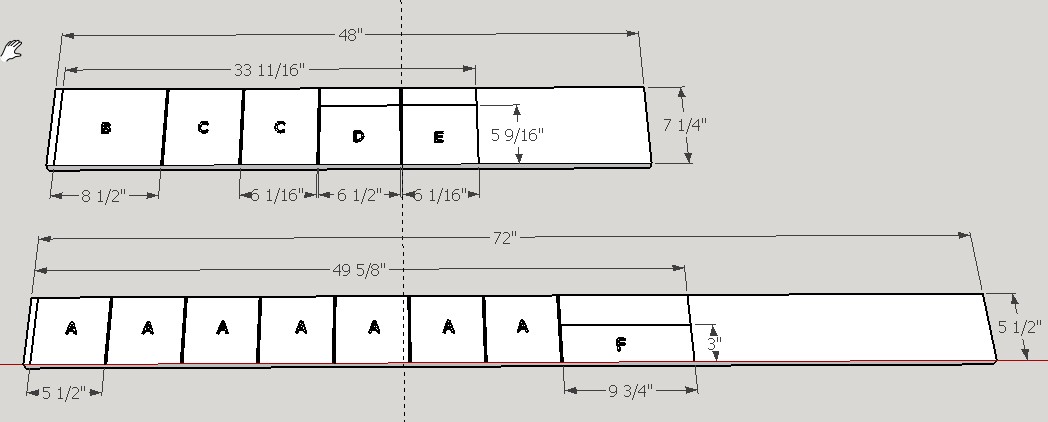

I have finished the design and while I might tweak it a little yet I think the wood requirements are done. You will have a few piece left over but scrap is only wood you haven't found a use for yet.
Since it is possible to find wood that may have defects that will need to be cut out I will for now assume that you can select pieces that are use able enough for a bee house or that you buy some extra wood so you can end up with such good wood as is needed. I will be shopping for the wood in the next couple of days so I will show you what I found if that helps.
ScreenHunter_110 Mar. 10 13.00.jpg (36.49 KiB) Viewed 14069 times
This will be the general cutting done with just the major dimensions shown.

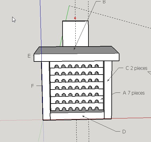

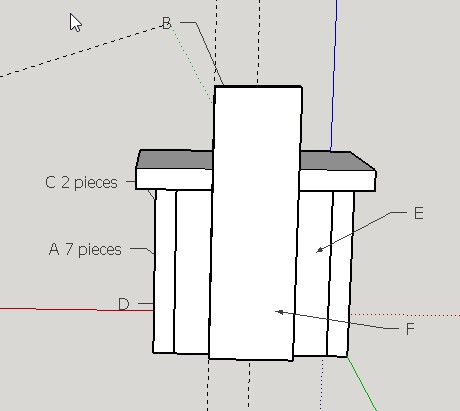

Re: Today in your shop (mason bee house anyone?)
I just updated the design and added a few more dimensions.
Could any of you interested in making this have any problem using these drawings to make this? There will be more verbiage and pictures as we go but I just wanted to make sure we have not lost anyone already.
ScreenHunter_111 Mar. 10 16.34.jpg (34.07 KiB) Viewed 14056 times
ScreenHunter_112 Mar. 10 16.34.jpg (18.25 KiB) Viewed 14056 times
ScreenHunter_113 Mar. 10 16.35.jpg (42.57 KiB) Viewed 14056 times
I might be going wood shopping tonight so we are getting close to getting some wood cut.

Nice work so far. Measurements and plans are easy to follow.

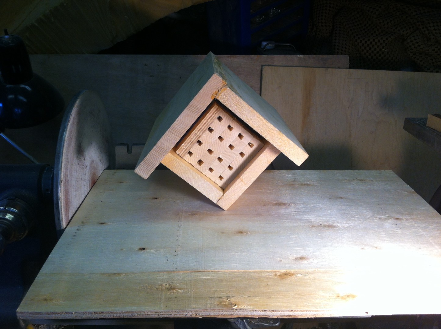

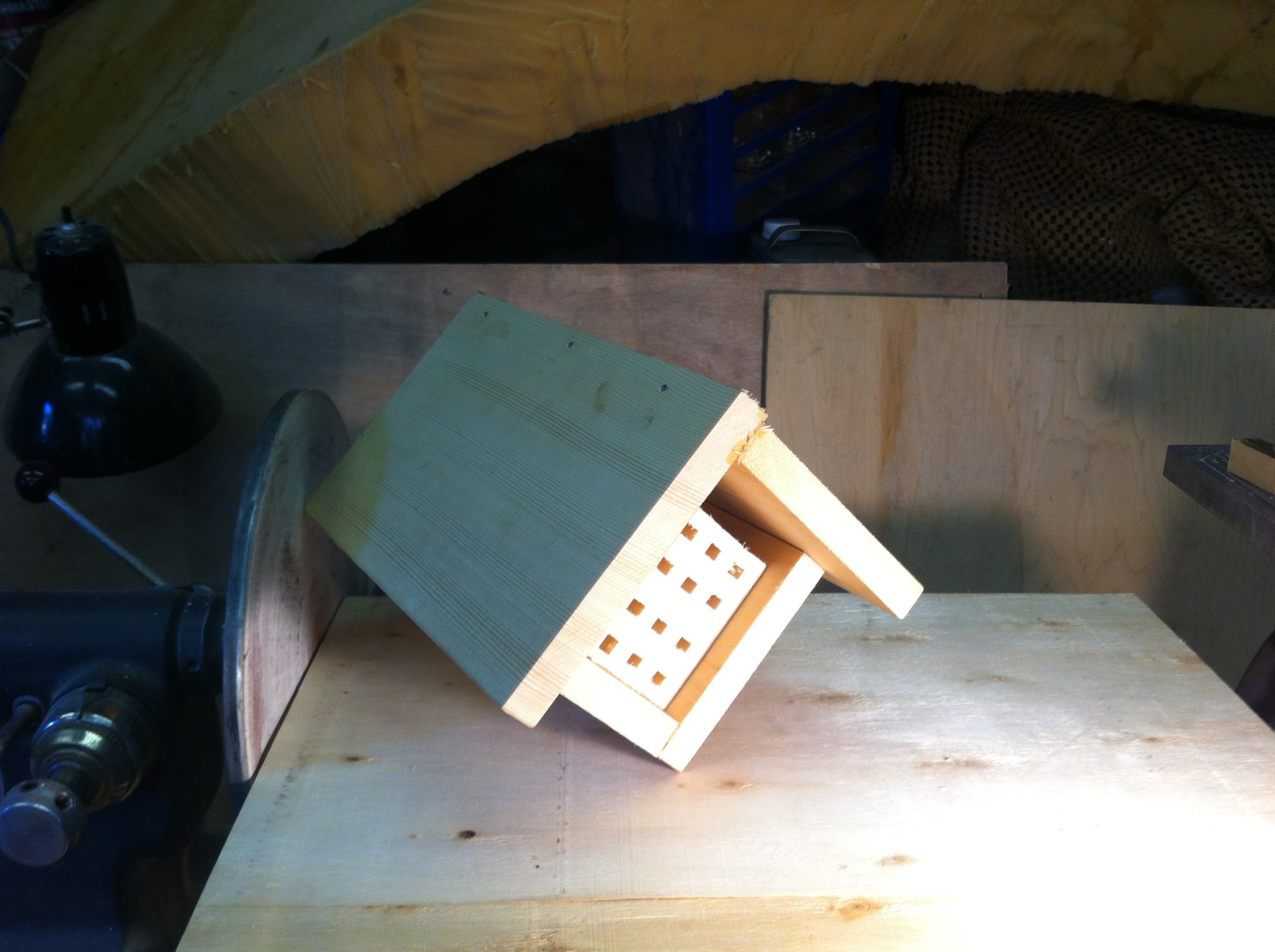

Coincidently I started building a mason bee house myself this last weekend after not getting to it for several years. :o
Still a work in progress.
Here are a couple of photos
bee house front.JPG (270.96 KiB) Viewed 14054 times
bee house angle.JPG (230.94 KiB) Viewed 14054 times

Even I can understand it, Ed, so it must be OK so far.
