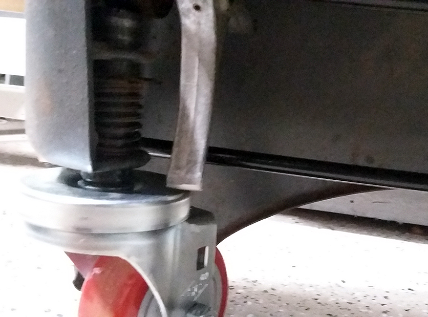

Sorry should have added the pictures,
Sorry the clearance is there, hard to see
Caster 1.jpg (346.04 KiB) Viewed 1038 times

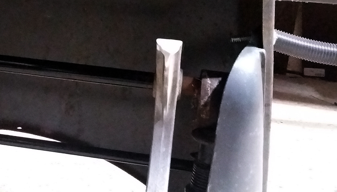

Showing where I ground it down.
Star Arm.jpg (428.11 KiB) Viewed 1038 times

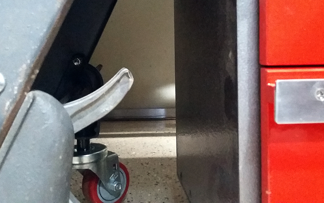

Side view showing how little was removed, maybe 3/16"
Re: New Casters
OKAY. THANKS. Now I understand the dilemma. I have read about this problem but since my pedals are located differently I never gave it a lot of thought. The pictures really helped.
