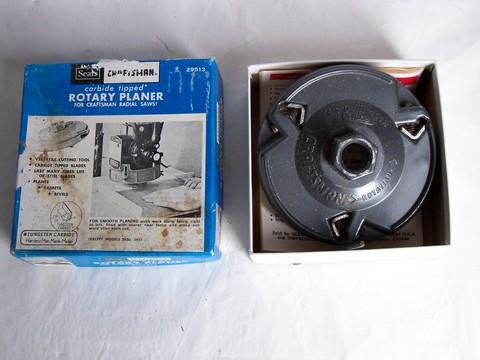

Here are two pictures of the packaging:

Excellent story Ed and I'm glad you stick to your guns.reible wrote:I got one of these pretty early on when I stated to equip my shop. It was small and easy to store so it provided added functionality with almost no down sides. As my shop grew other tools were added and most things I could do with it I could also do with another tool.
Then came carbide, steel tools need sharpening and effort to keep then tuned up where as carbide takes a beating and keeps on ticking. You have to keep working on the cutters, inside edges only and while not difficult or even all that time consuming it was never one of my favorite things to do. So you add kids and other time consuming things in life and pretty soon you go to use it and HEY it needs sharpening(again) so you grab a router bit and that happens more then a few times. Pretty soon you need some space for router bits or what have you and so you move the planner to a different location. Fast forward a year and it "where did I put that?" Then you find it and yes it still needs sharpening but what did I do with the grinding wheel? How come they are not together anymore?
So a couple of years ago I got all components back together and though maybe it was time for new cutters. Oh boy Wagner doesn't make these any more..... so I started looking for other alternatives but on the back burner.... and here it is today.
That's my story and I'm sticking to it. And yes I still know where it is, I think.
