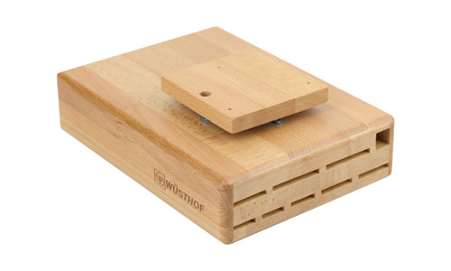

Here is a pic of the one I copied, I needed more slots then that one.

I understand that is a stock photo but are you a Wusthof or a J. A. Henckels guy? Or something else?ERLover wrote:Here is a pic of the one I copied, I needed more slots then that one.

Ya the one I made was layered with Walnut and Cherry. It has 3 rows of blade slots not 2 as the pic I posted, and I counter sunk a 1/2'' diam regular magnet in each slot. Not that I would think one would slide out on its own, except for short parring knives.
