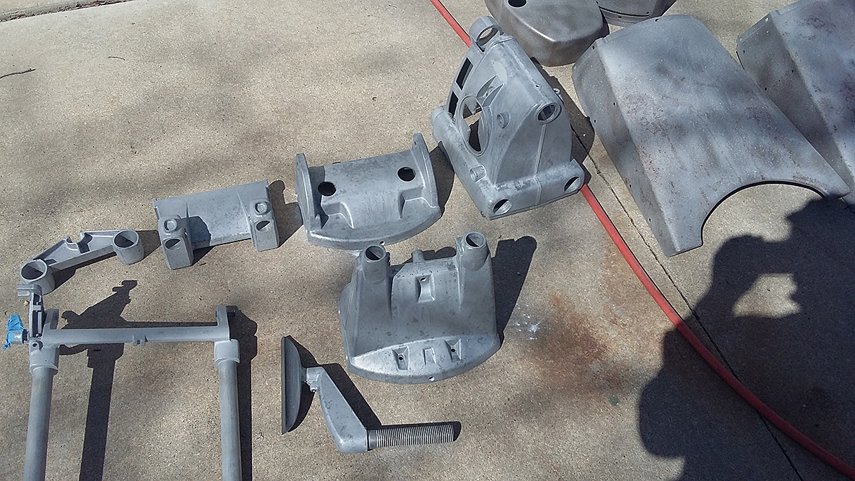

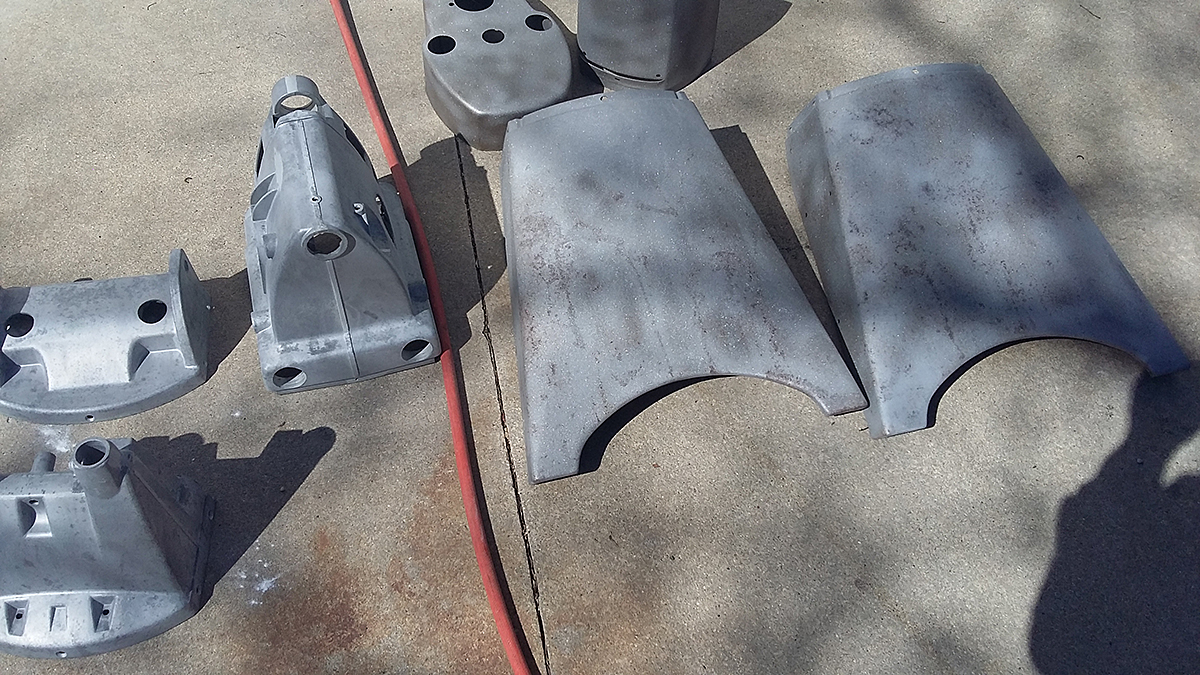

All the parts are blasted, steel with Black Blast and aluminum with Soda Blast.
Tomorrow Primer and Paint.
See new post on Soda blast for more pictures on Soda Blasting.

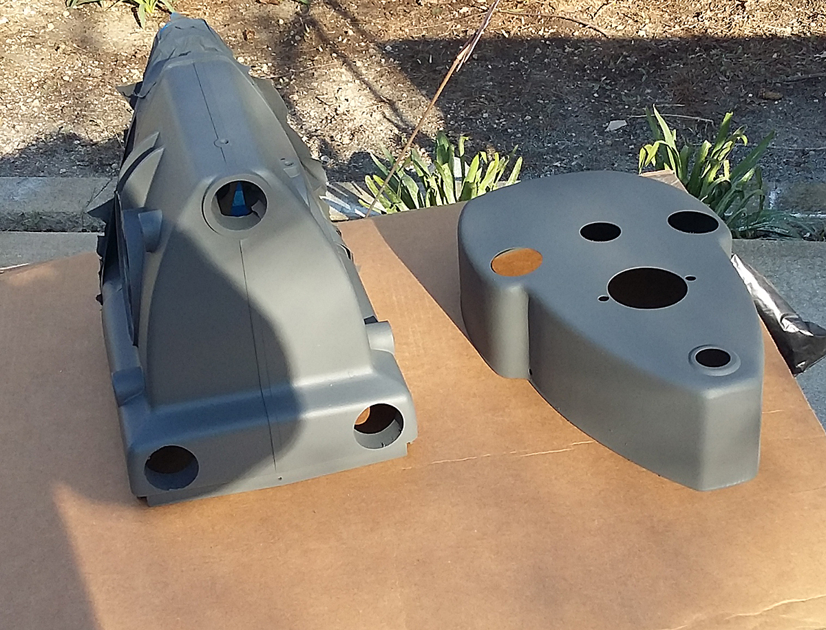

Yesterday I got everything primed, as soon as the temp out side gets up to over 56 degrees I will get it painted. When I was younger i would have gotten all this done in one day. I guess I am slowing down. Slow but sure.
A couple of representative pieces.

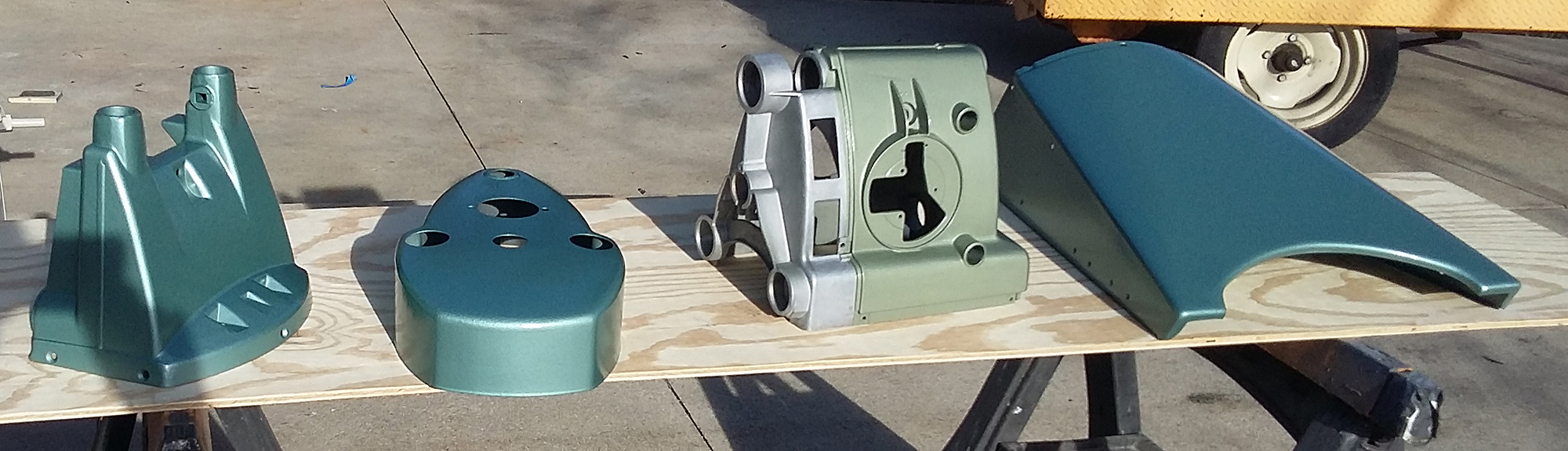

great weather, got everything painted today, will let sit for a day or two to get a good dry going. The Xylol drys to he touch fast. Here are a couple of representative items pictured.

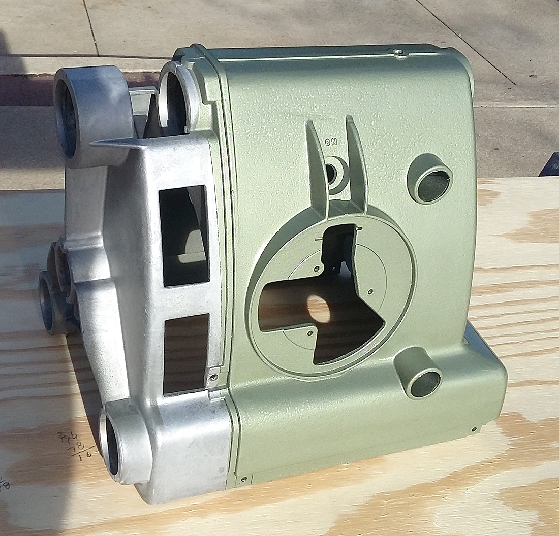

I left the end that is under the steel cover unpainted as original
Headstock Paint.jpg (917.61 KiB) Viewed 3211 times
